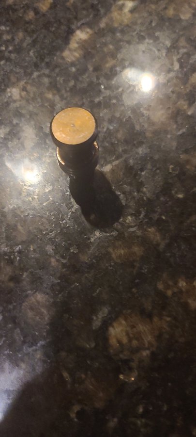

Default Spring and pin
So I had this happen to me as I was chaning the hi pressure line and had to remove large coupler that threads into the pump, I think it was like 21 mm as it was stuck to the 15 mm inlet for the hose .
but this pin and spring fell out. Thought i put it back right but no power steering at all when i put it back together. I put the pin in first with the flat head and the little filter end on the bottom then the spring and then the big bolt coupler.
i saw this post bupost a little confused still on the order
Any help is great
