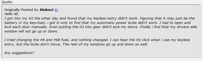

Originally Posted by Alukavi
Hello All,
I got into my H3 the other day and found that my keyless entry didn't work. Figuring that it may just be the battery in my keychain, i got in only to find that my automatic power locks didn't work. I had to open and lock each door manually. Even putting the H3 into gear didn't lock my doors. Finally i find that my drivers side window will not go up or down.
I tried changing the #8 and #68 fuse, and nothing changed. I can hear the H3 click when i use my keyless entry, but the locks don't move. The rest of my windows go up and down as well.
Any suggestions?
Hello All,
Any suggestions?
