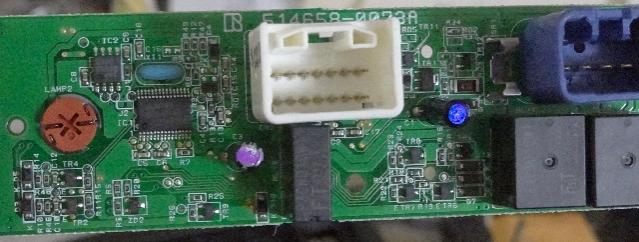

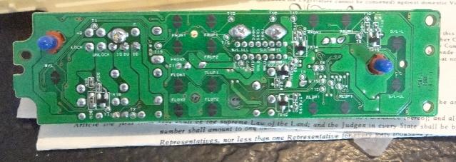

Originally Posted by Rjbaum
I recently replaced my 2007 Hummer H3 battery, after replacing battery the driver's side power window and door locks stopped working. The other three power windows worked normally. I fixed the problem in the following manner;
1) remove key from ignition, turn off all lights, accessories and close all doors.
2) remove negative battery cable from battery
3) short negative battery cable to the positive battery cable, I used one side of a set of jumper cables to make the short. Make sure the negative battery cable can not touch or contact negative battery terminal ( otherwise you will be arc welding)
4) leave the the short in place for at least two hours.
5) after two hours, remove jumper cable (short) and reconnect negative battery cable to battery.
I can't believe this fixed the problem , but it did. Good luck.
I think this guy has it. number 3+4 should do it without pulling the sw..
you can see that the bcm has just 2 wires going to the dr door module.
the lock wire is simply connected in with the dr door sw and the pass door sw. all in parallel. the bcm wire is even labeled "pass door lock sw control so this is only a logic line pulling to ground like the other two switches.
the bcm "door unlock wire" is more interesting. it goes ONLY to the dr door unlock on the door module. it would appear that only the dr door could be unlocked by the bcm. look at the wiring.
remember it takes 2 pushes on the fob to unlock all doors. that 2x pulse goes into the dr unlock wire and that's where the module logic takes over, within 3 seconds, 2 hits opens all doors. that logic is self contained in the door module and the fob signal goes to the bcm only, so pulling the sw and moving it would be like moving your key away! the key and the mofule never get a signal from the fob.
so it needs to be reset if it for whatever reason it upchucks. theres no relearning as the chip on the module board,along with a pile of transistors is programmed to do its thing and has no "smart" data lines going to it.
shorting,(or pulling it) resets it when the capacitors on the board get discharged.
the 3 relays are soldered so you cant swap them
more later
Attached Thumbnails Power Locks and Driver Side Window not working-door-wiring.jpg   Power Locks and Driver Side Window not working-doorswb-1-.jpg   Power Locks and Driver Side Window not working-doorswb-2-.jpg

There you go again with that gibberish. Shorting a circuit can cause an immediate problem or problems down the road. I do NOT recommend! Disconnecting the switch works, and will NEVER cause any damage. Many others have verified that. You can go ahead and short circuit, although it appears you already have. nuff said!
