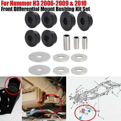

Have Fun replacing the front differential bushing; just did mine not too long ago and it was a total PITA. Could not imagine doing it without a hydraulic press. Lots of good information and videos out there on how to remove/install it, but be extremely patient during the install; if the bushing doesn’t line up exactly right and gets crooked, don’t simply try to force it in there and think “oh it will straighten itself out”. Back it out, line it up, and try it again.
I got greedy on my first attempt and tried to jam it in with a hydraulic press the first time, and I ruined my first bushing, so I had to order a second one. This time I was much more careful and it worked out a lot better.
Additionally, when re-installing the massive bolt that mounts to the differential, make sure the tip of the bolt has enough space from the oil pan. Otherwise the bolt will scrape/eat into the pan. If it does, you’ll hear some pretty atrocious vibrations and sounds from the engine bay when the two rub against each other.

Lol, yeah the 2 small ones killed my arm from 2 days of hammering so could only imagine. Fortunately I got the energy suspension ones, they dont use a metal sleeve so makes it way easier.
Polyurethane Front Differential Side Mount Bushings for Hummer H3  H3T 2006-2010 - Picture 1 of 17

Might want to look at Outfitter Designs as they make high quality replacement kits for bushings and other goodies.
