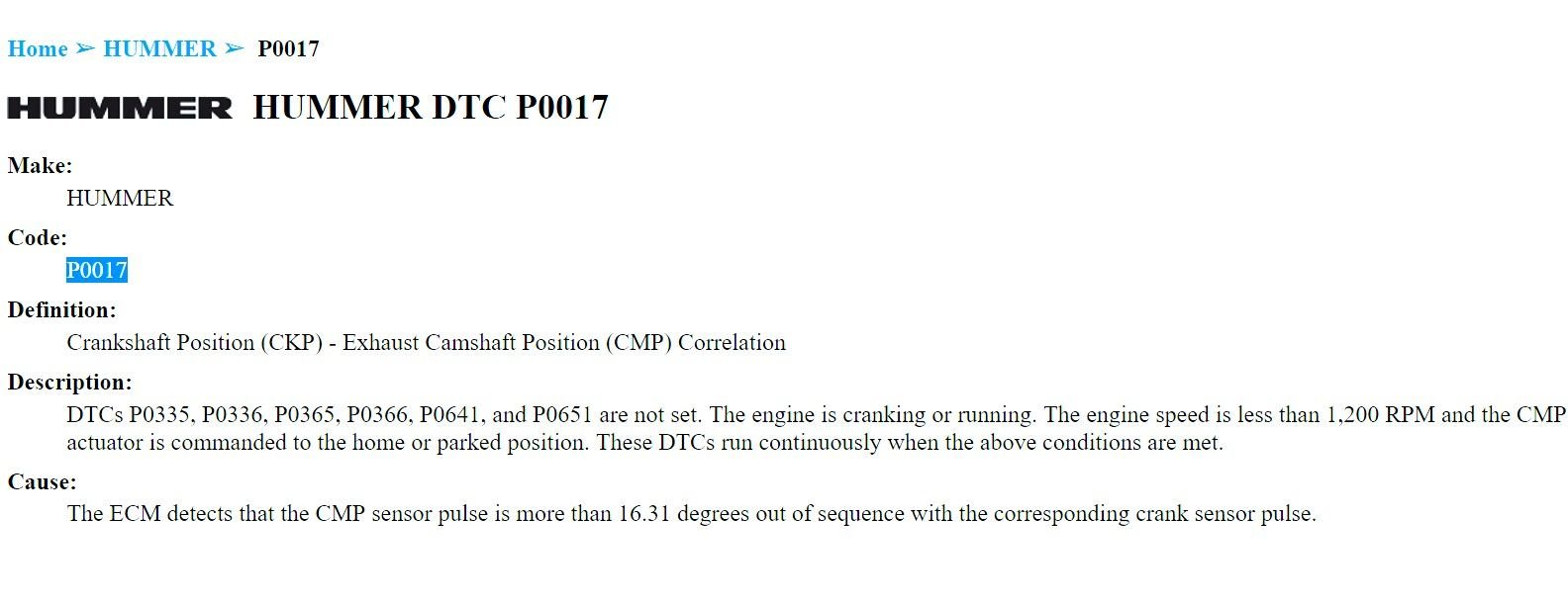

The P0017 OBD-II code signifies a correlation issue between the crankshaft position and the Bank 1 exhaust camshaft position, meaning they are out of sync, often caused by problems with the engine's mechanical timing, the Variable Valve Timing (VVT) system, or issues with engine oil. Symptoms can include poor engine performance, a rough idle, sluggish acceleration, and reduced fuel efficiency, making it recommended to have the issue diagnosed and repaired promptly.
Old Sep 4, 2025 | 07:41 PM
Posts: 9,014

Thanks hummerz... good data.
