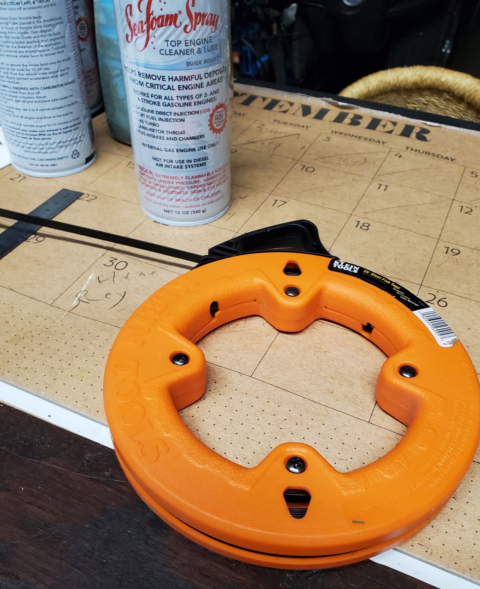

So thinking of ways to remove breakdown debris from exhaust cat # 2 failure.
What about this possible remedy...

i had to remove mine to acess it better. the ceramic honeycomb is wrapped with some sort of a cotton or paper looking material reminds me of old school asbestos wool mat. that you probably need to also get out as not to clog the muffler any more than it might be.
Yes, the snake was NG. Looks like pulling it apart is best. Its a dirty job but some times you take one for the team...
