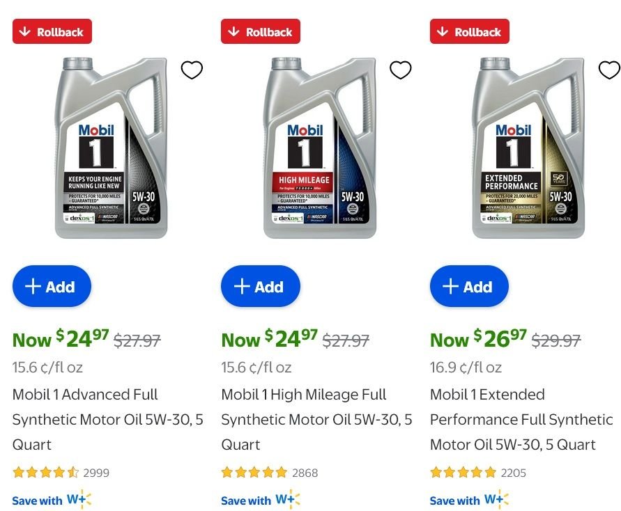

Get some MOBIL 1 (Walmart sells it cheap with free delivery) & change oil after running some miles with Seafoam inside the engine.
