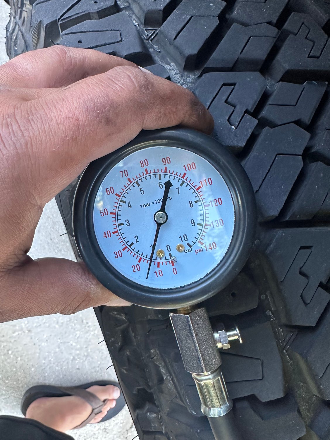

So I got the new kit, plugged it in and started the hummer cold start was at 65psi and fully warming up the engine at idle it start to go down and it stopped at around 14psi
and since I changed the oil and put new one and new sensor and wire harness it didn’t happen again since then. I had few cool days that I thought maybe it’s cool but what I ment cool was in the 70s and today is 80 and still didn’t do it .. so I assume problem fixed? Lol
14 is great I also replaced my pigtail that plugs into the oil pressure switch new oil after they did all that work I’m at beach over 200 miles knock on wood no oil light can you post when kit you ended up getting

sensor range for actuation is 0.4-0.5 bar. Check your sensor when it works. This can be done using a pressure gauge and an air compressor.
the test kit is the one above in the replies , I replaced the sensor and the wire that plugs to it and then did oil change and put fresh mobile one oil and filter
