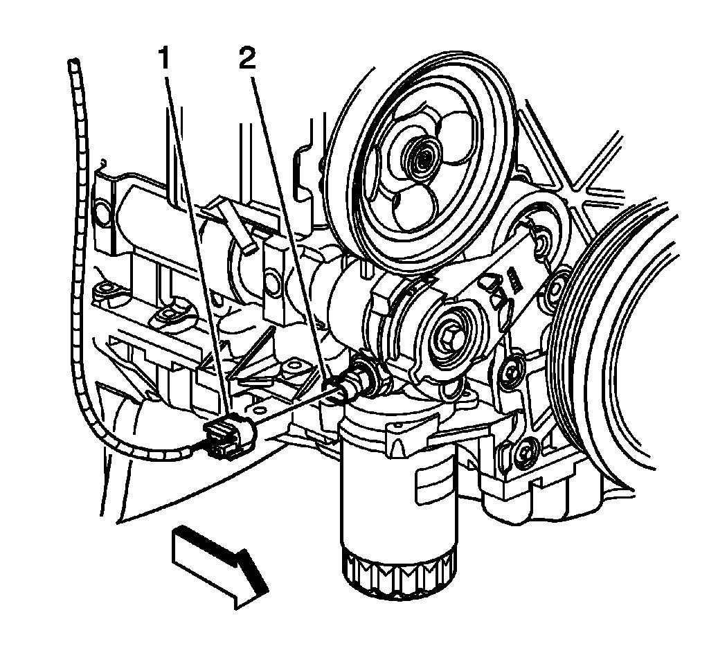

Anyone got a video on changing the oil pressure Sensor? Mine is out of service...
Old Jun 22, 2023 | 04:10 PM
  #57
Posts: 9,024
Its above the oil filter.
Engine Oil Pressure Sensor and/or Switch Replacement
Removal Procedure
  1. Remove the engine shield.
  2. Disconnect the oil pressure switch electrical connector (1).
  3. Remove the engine oil pressure switch.
Installation Procedure
  1. Install the engine oil pressure switch.Tighten: Tighten the switch to 20 N.m (15 lb ft).
  2. Connect the oil pressure switch electrical connector (1).
  3. Install the engine shield.

Posts: 9,024
2006
Removal Procedure
  1. Raise and support the vehicle.
  3. Lower the vehicle.
Old Jun 23, 2023 | 04:04 AM

Another question for those who have performed this task, changing the oil sensor. Is it possible to perform this from the Top Side? The illustration indicates doing it from the Bottom.
Please advise only if you have done this one way or the other,
Old Jun 23, 2023 | 08:48 AM
  #60
Posts: 13,105
Thanks for that Hummerz...
Why? It is directly accessible from the bottom with the splash shield removed and you don't need to lift the H3 if you can lay on the ground.
