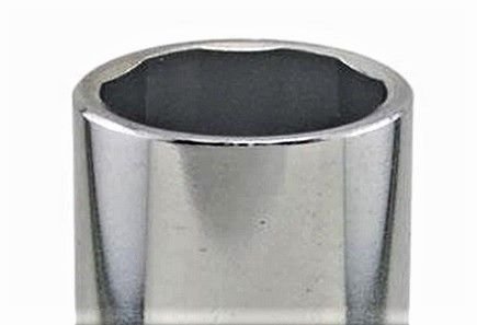

[QUOTE=NFS;400043I forgot what socket size do you use to take off that sensor ?[/QUOTE]
should be 27mm or 1-1/16"
Also needs to be 6 sided. 12 will not work. Might be best to get an actual oil pressure switch socket, but I'm sure you could get it with a regular deep socket.
Always use the right tool for the job!
Cheap at your local parts store:
OEMTOOLS Oil Pressure Switch Socket $11.99
