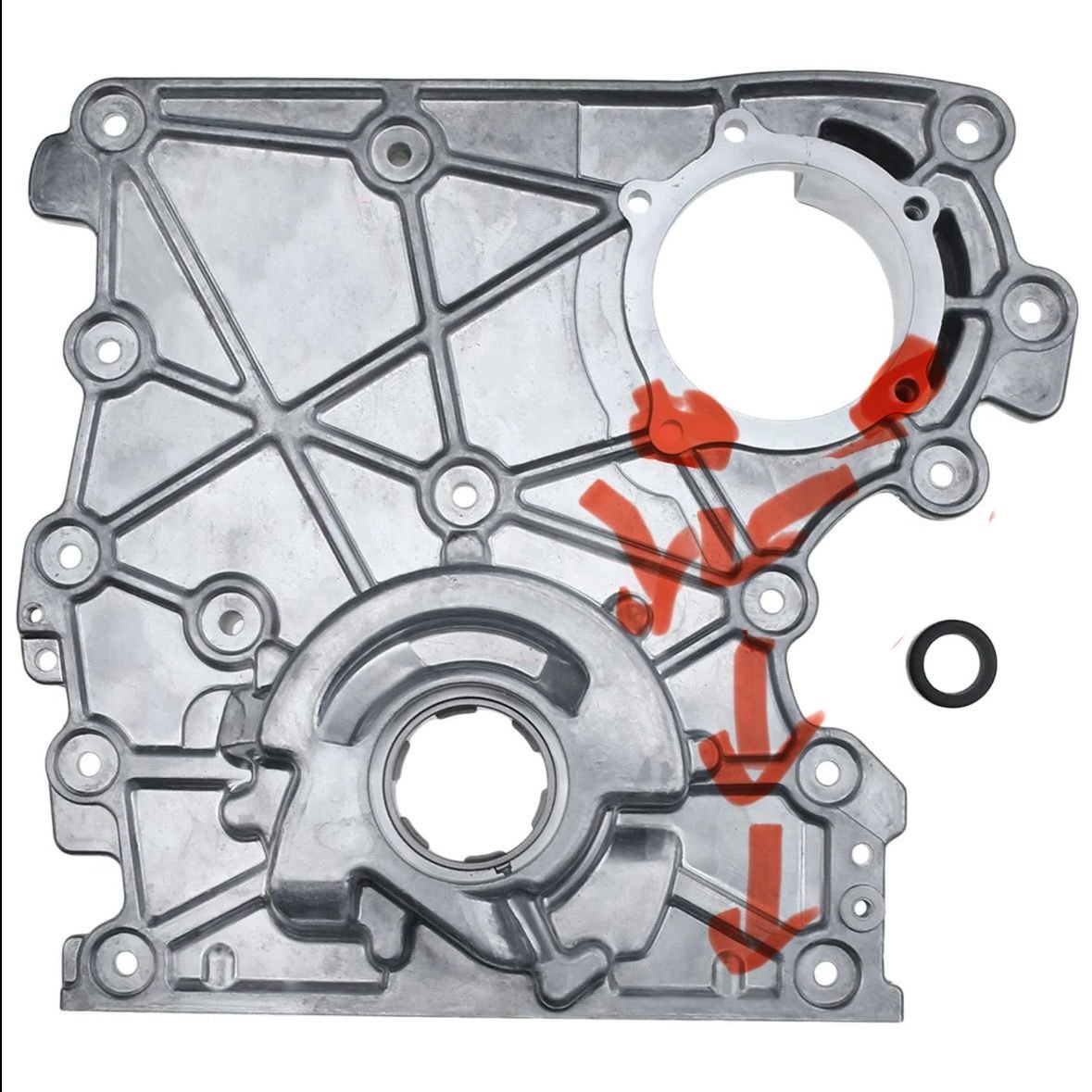

so where the red I think that’s where it’s leaking from those holes I believe and it like sweep slowly where the red arrows are
You: do whatever. Me: PULL THE COVER, CLEAN, & PROPERLY SEAL!
but pulling the cover will require taking off the oil pan again and all that

do those bolt holes go into the oil galleys of the block? if they do maybe just pull them and add sealant to the holes and bolts and re torque them.
I don’t think it’s the block becuase the ones that goes into the block is the ones that hold the timing cover and those don’t have a single leak it’s only the ones that hold the water pump which I believe it just goes into the oil galleys that’s what I probably gonna do if that’s the case
