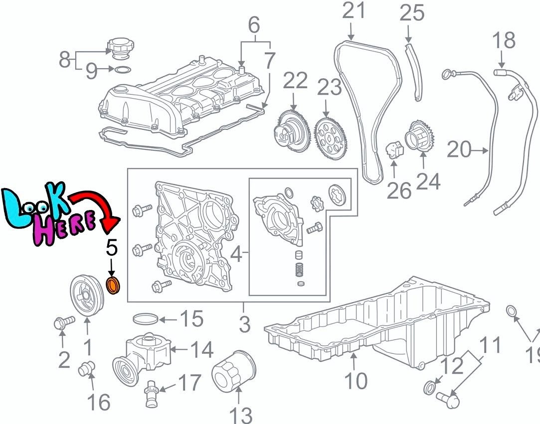

it’s def not from there becuase I out a new gasket there when I put the harmonic balancer back. I can see it coming from behind the water pump above the compressor tho

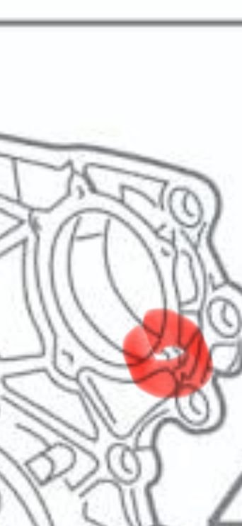

Yes I did that it’s not leaking from the front cover it’s leaking from the water pump section like the button where I circled

Front cover cracked? If so a replacement on Ebay for $98usd or Best Offer>>>Engine Timing Chain Cover w/ Oil Pump

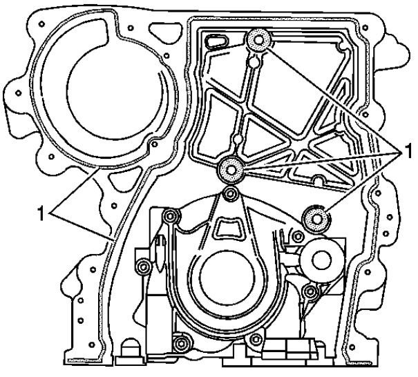

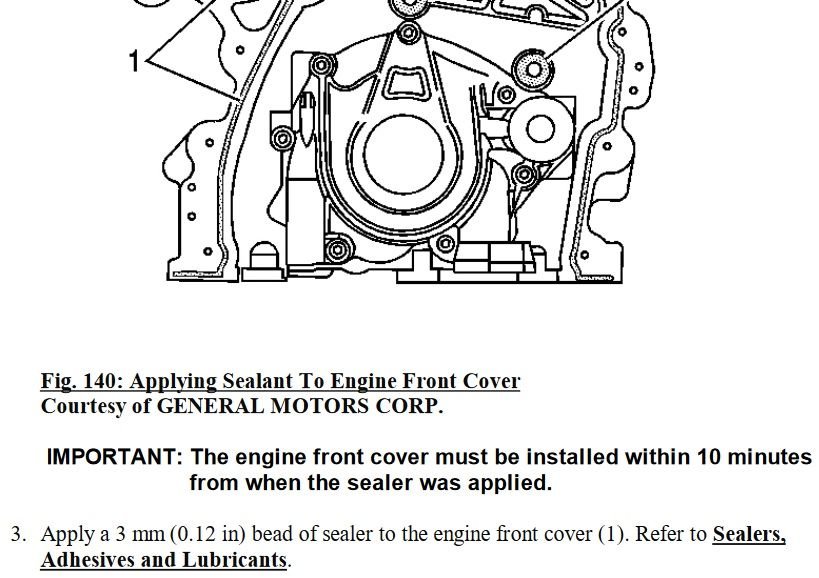

Btw, a 1/8" bead of sealant needs to go all around the groove including around the water pump mount and 3 spots as shown here #1:
