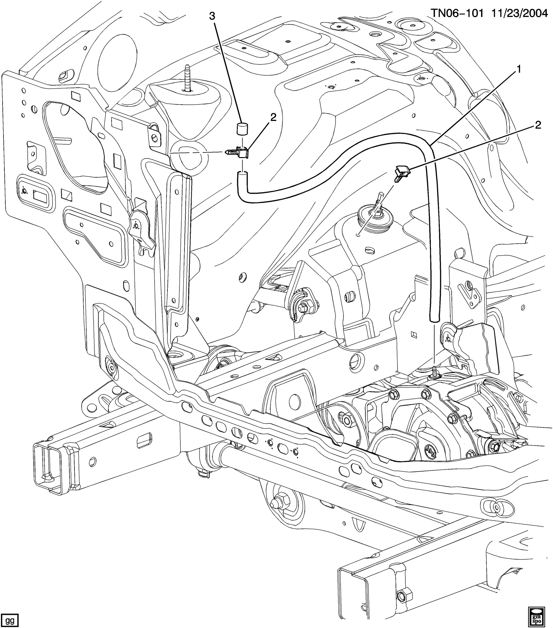

Check the diff fluid level. If not overfull, power wash the underside with soap and see if it continues.

Inspect the vent tube!

I made that suggestion because the #1 cause of diff leaks is............. OVERFILLING! So, if you added some (too much) then this started, you know why.
Good luck and keep us posted.
