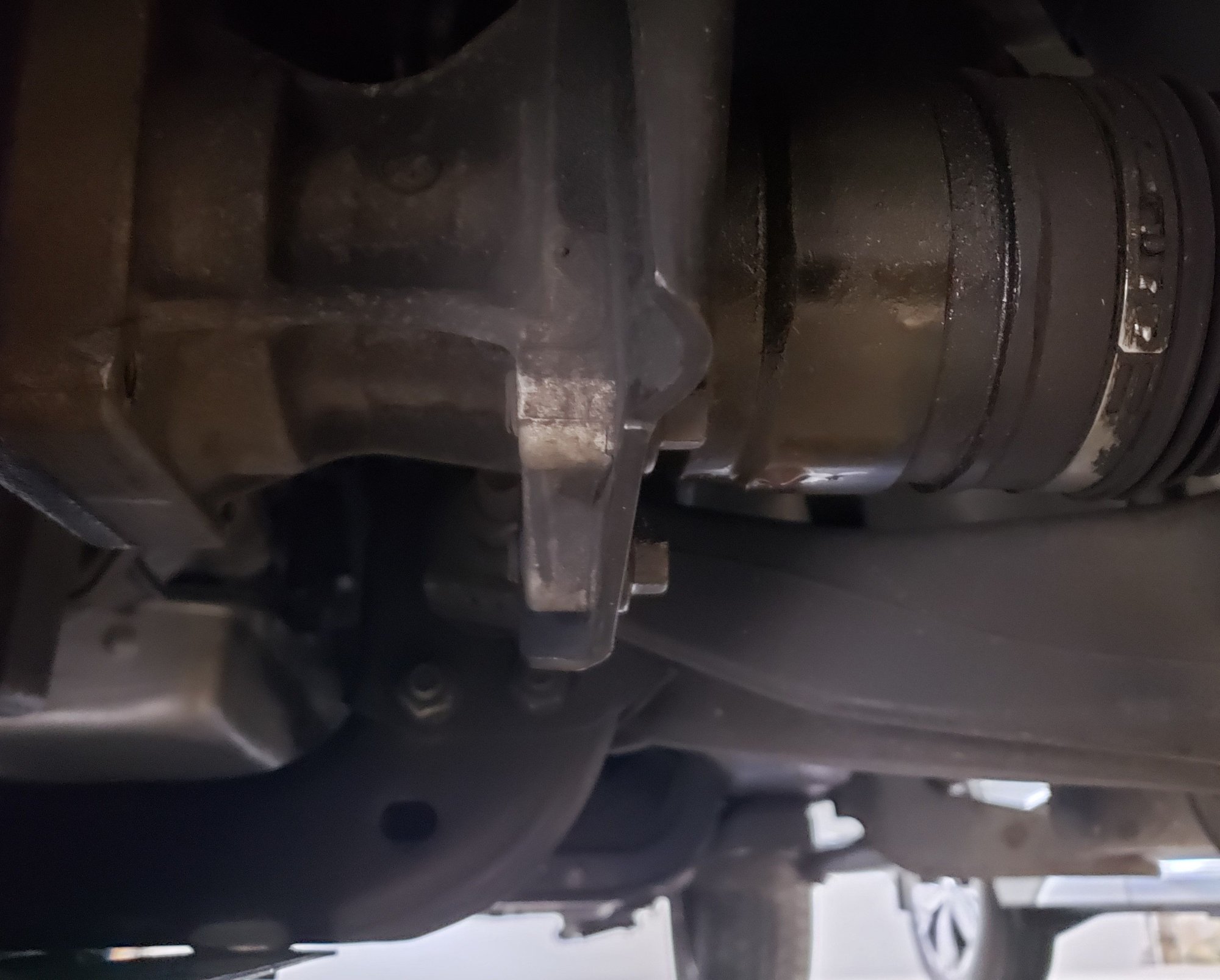

Hey Guys,
Any clues on where this fluid leak. Looks like motor oil is coming from?
B4 I remove the shield plates looking for suggestions on where to start probing. My rig is a H3 2006 with 103k on the ticker.
See 4 pics
Spot on the floor directly below
Another view with spot directly under drip point
Seems to come off Boot at times
Darker view off boot drip point.
Old Sep 4, 2021 | 02:24 PM
Posts: 9,046
Does it smell like diff fluid, output shaft seal? Btw, windows photos has an editor option.

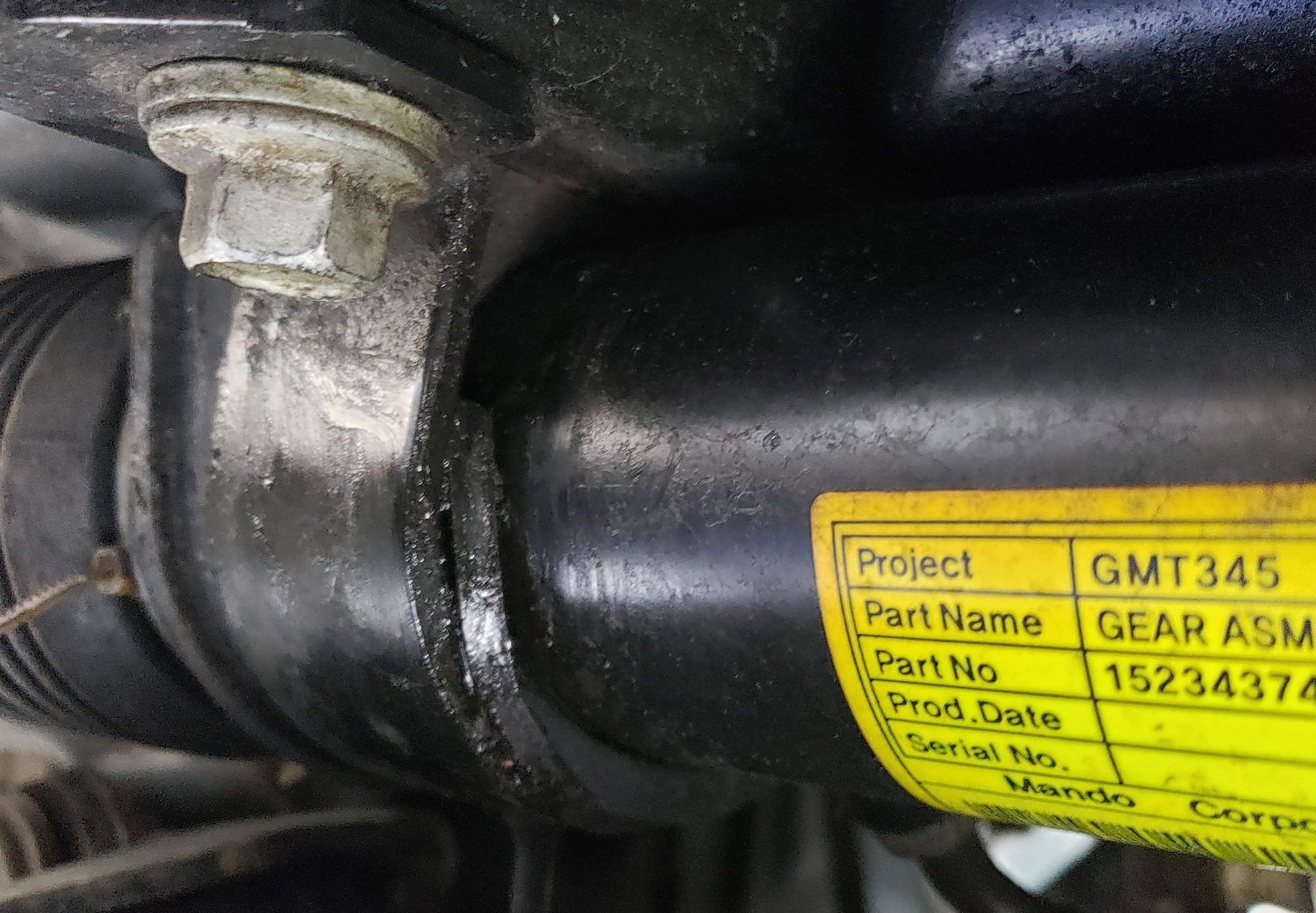

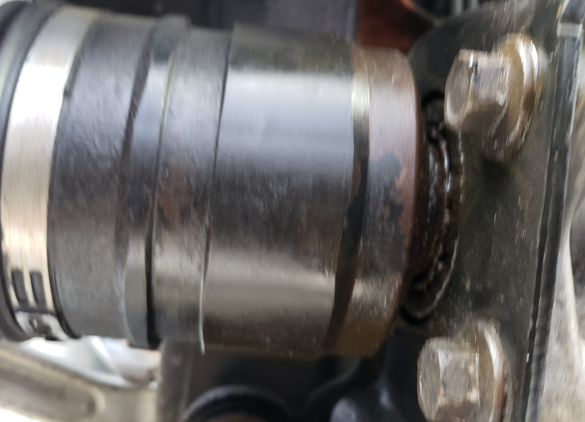

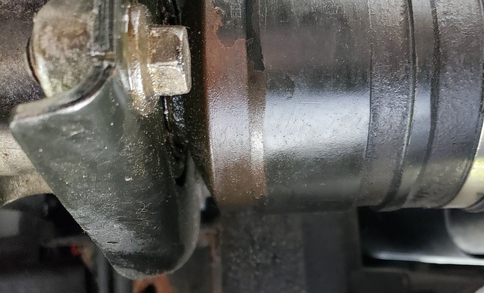

OK follow up pulled off the shields and inspected.
Look a little wet in two locations. 1) Where the CV shaft seal enters the housing 2) Under the Power steering ram housing.
Suspect the Shaft seal since the gear reservoir
Joint
Joint
Pwr Ster
Pwr Str
was low and needed a few ounces of gear oil. It had been changed and filled only 5k miles ago.

OK after looking again this AM the leak has been identified as the Shaft Seal. As suggested by one of the Guru's here.
Thanks to all. Now to find someone to fix this. Beyond my skill set.

And you'll get the PS bushing rectified also?
Old Sep 6, 2021 | 05:22 PM
Posts: 9,046
Good call. The bushings will move with fluid intrusion, it's replacement time.

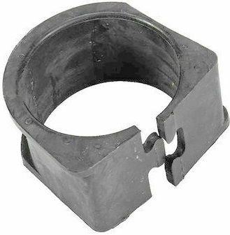

Default Part?
Thanks for that...
Anyone have a part # for this Power Steering bushing?
Old Sep 7, 2021 | 07:33 AM
Posts: 9,046
