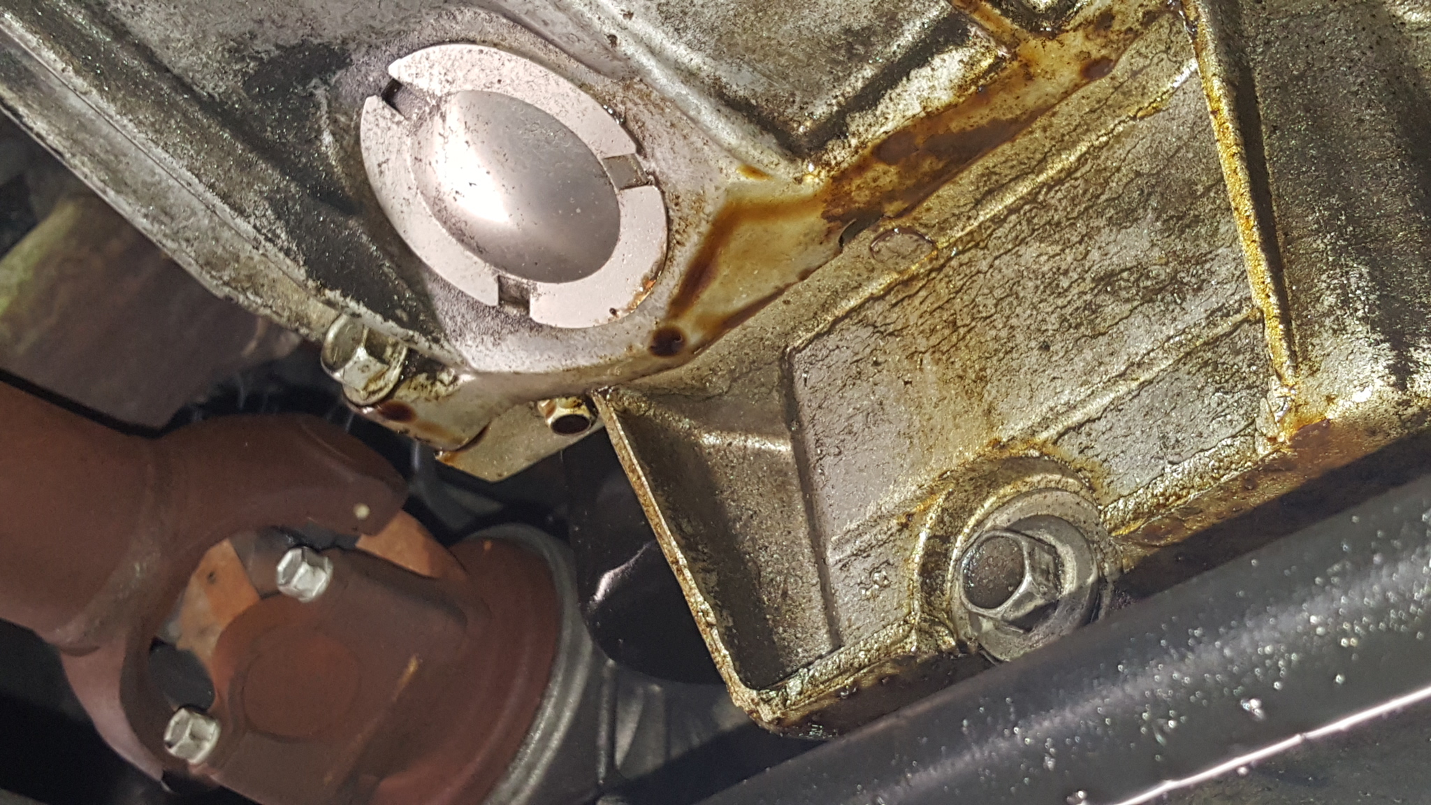

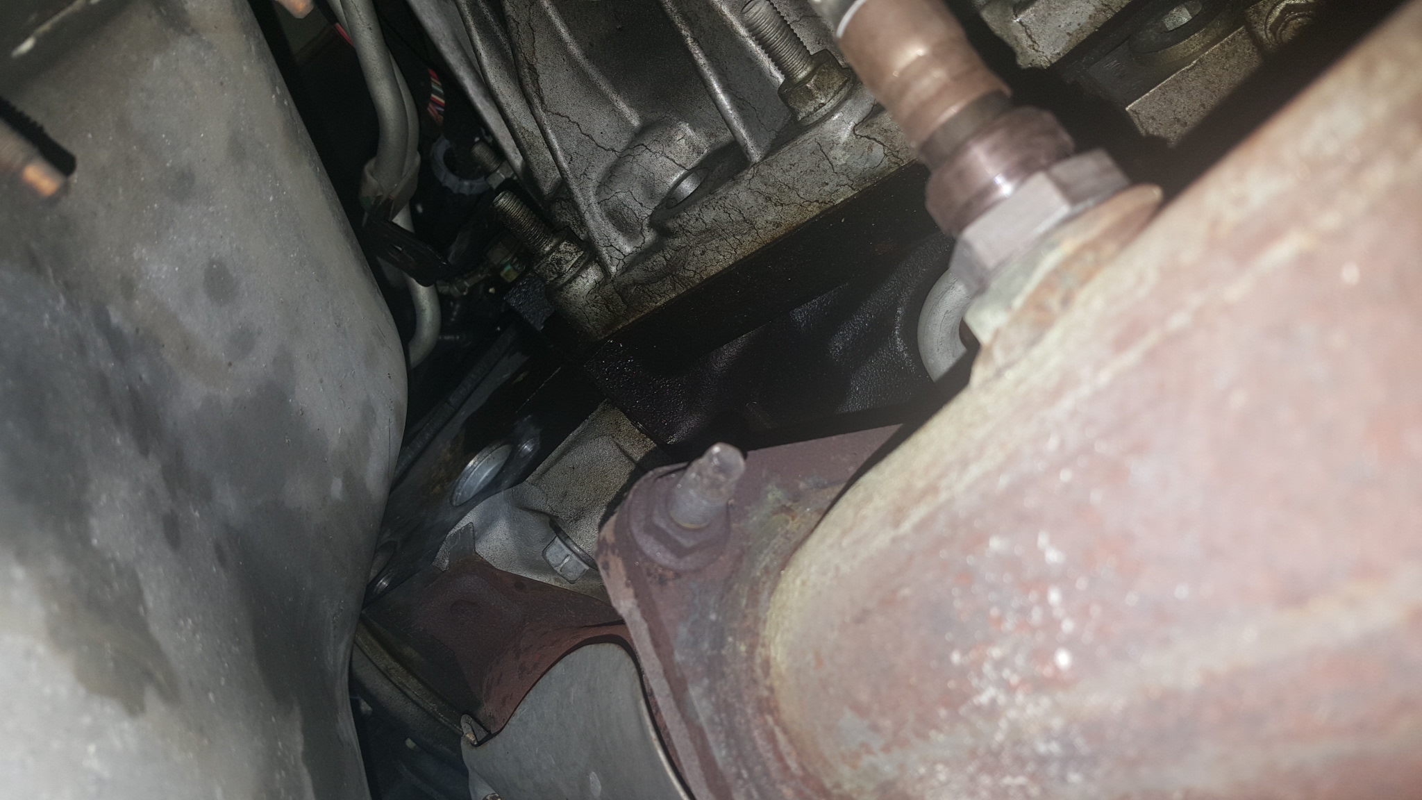

I just notice a slight oil leak .
I got to do a double check but the oil looks to be coming between the engine and the converter. It is engine oil , not transmission fluid
Does anyone knows what the fix will involved
My biggest concern will be the oil mixing with the tranny fluid
Any ideas appreciatte
Thanks

By the info I could got online leak could be coming from the main rear seal or the gasket .
Both looks as a pain in the rear to replace
Either the tranny has to be removed or engine pulled out
I guess Im going to clean everything to get a better idea how much is leaking
Had anyone used bluedevil or any other stop leak additive.
Im more scared to put additives on the oil that leaving the oil leaking
Btw not a significant oil lost amount reflected on the the stick

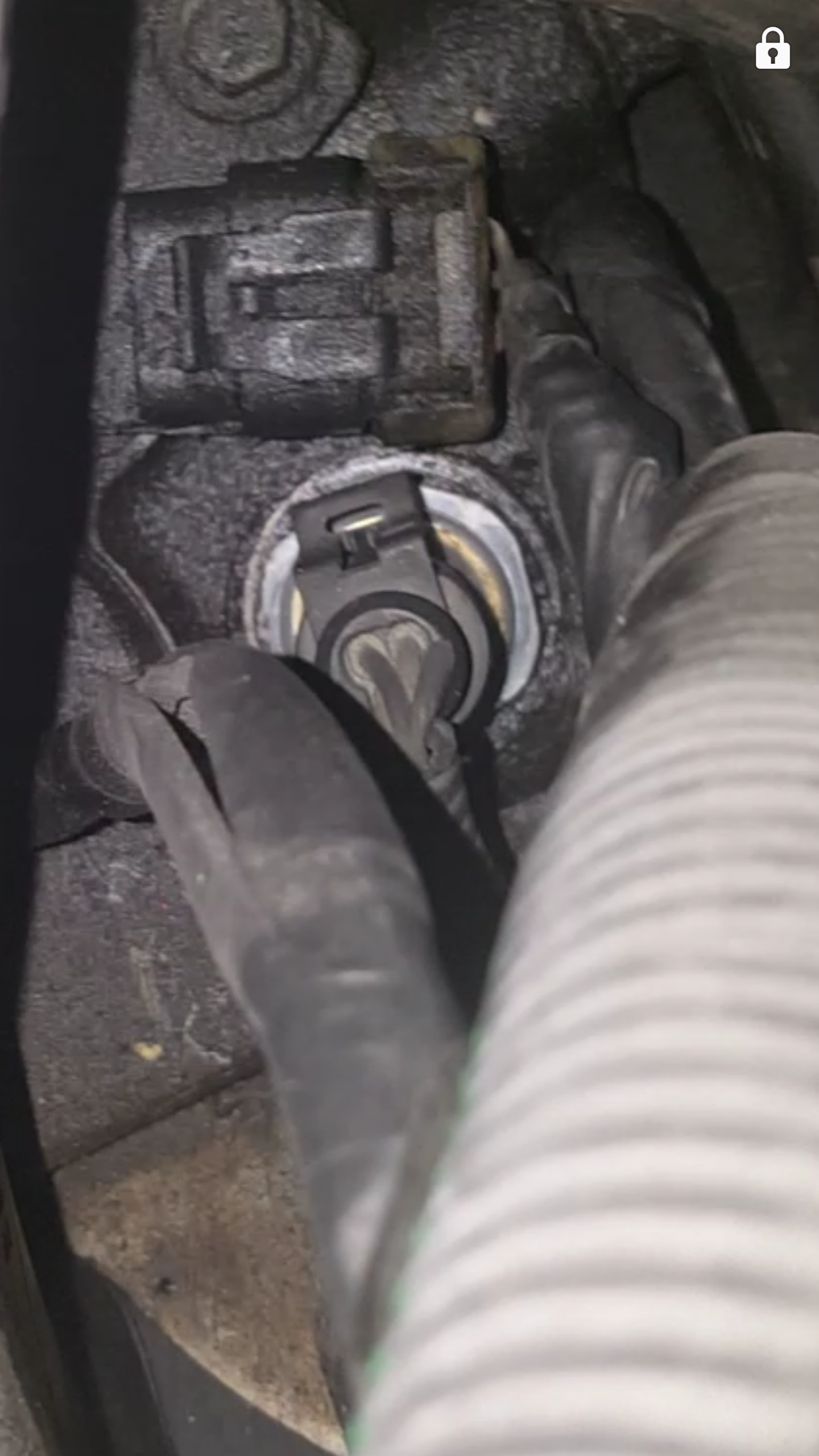

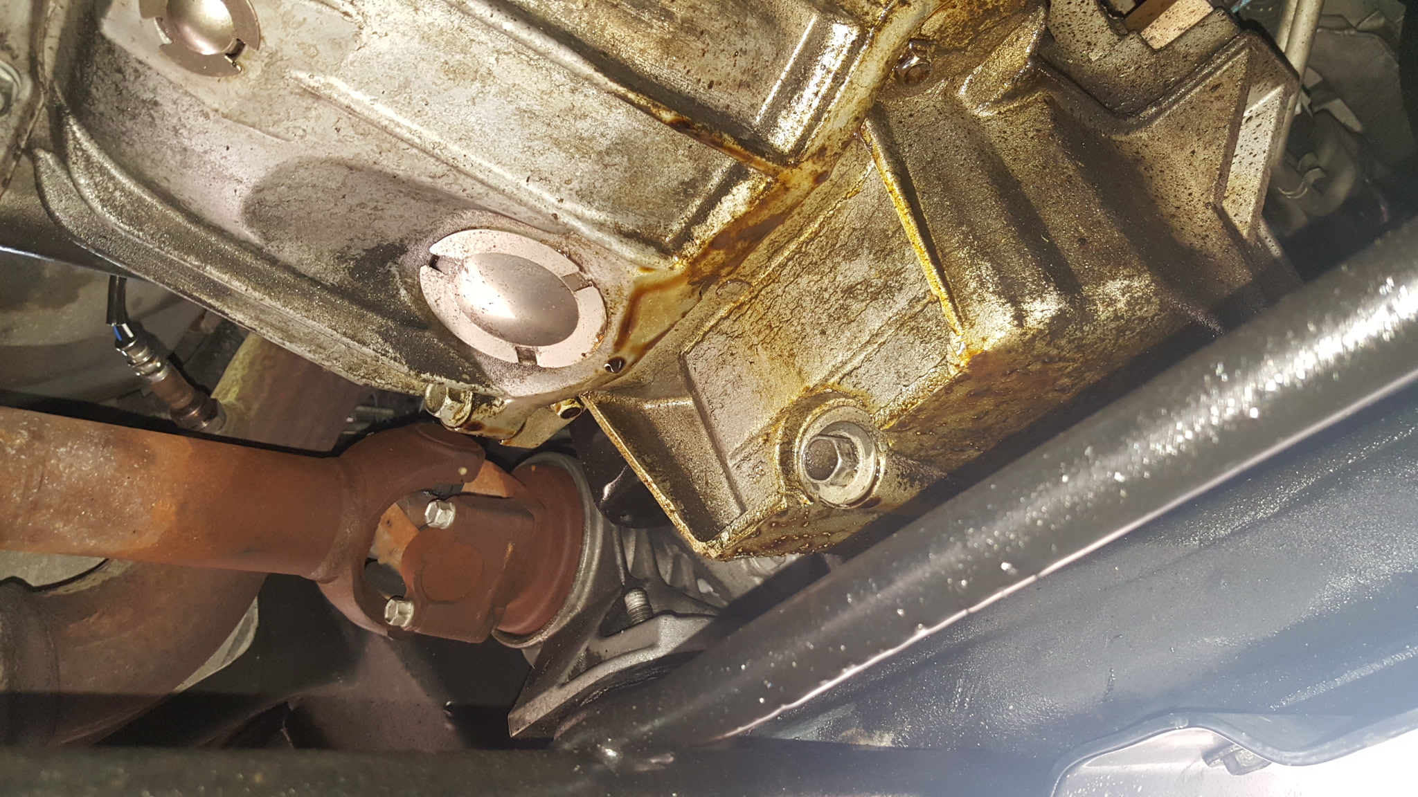

I checked for oil running from the top ( oil sending unit) and found some oil marks on the side . Also the oil sending unit is very dirty around . It looks as burn oil mixed with dirt ...
what would you guys guess by looking at the pictures .
Should I re-tight the oil sending unit . leaking oil .. ideas?-screenshot_2016-03-16-18-53-00.png

It dosen't appear to be leaking. Maybe that is an old oily film leftover from when you last replaced the OPS. Spray it with BrakeKleen and see if it comes back.
