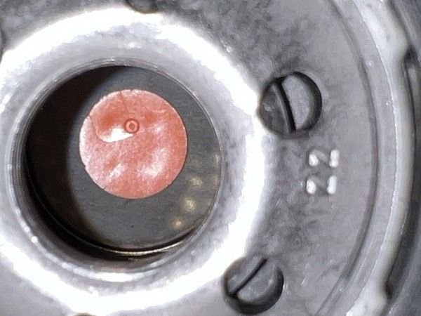

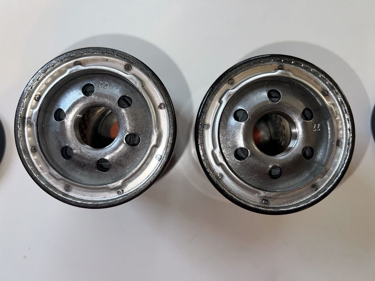

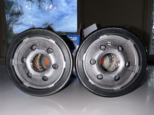

Closing this out, here's the comparison pictures. The filter on the left is the incorrectly labelled one I got from Amazon (Amazon was the seller, not a 3rd party). The filter on the right is a correctly labelled UPF48R from Rock Auto. The "PF48" labelled filter was made 9/28/23; the "UPF" labelled filter was made 2/5/24.
The filters are dimensionally within 1-2 hundreds of an inch of each other, and virtually identical cosmetically. Cosmetic differences include the orientation of the "ZZ" stamping in the baseplate, the size of the font for the date code on the top of the can, the appearance of the surface of the pressure relief valve, the quality of the paint on the lip at the bottom of the can, and a marking under the gasket that is only present on the one labelled PF48.
My conclusion is that both are genuine UPF48Rs that probably ran off of different assembly lines at the Champion Labs factory.

For those who might run into the same issue, I sent my photos to GM Global Brand Protection, who are the folks responsible for identifying counterfeit product in the supply chain.
Here's their answer:
"After reviewing the images and information you provided, both parts appear to be genuine. It looks like there was an issue on the production line in which the incorrect label was applied to the filter."
Now we know.
