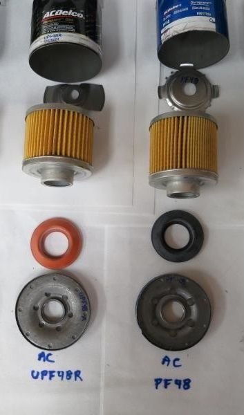

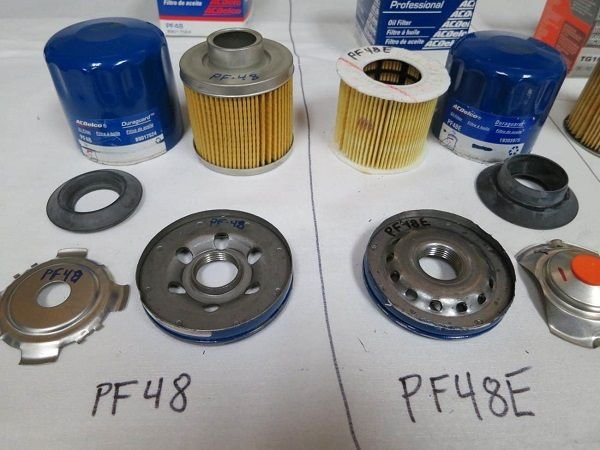

I'm getting ready to change the oil on my 09 Alpha. The manual calls for a PF48 filter. Easy-peasy.
Now, as I understand it, the PF48 was discontinued some time ago and replaced by the PF48E which has an "optimized" design, using fabric end caps "ultrasonically welded" to the filter media, a plastic center core inside the filter, a lighter duty base plate and a thinner can. The PF48 used metal end caps on the filter media, a metal core screen, a heavier base plate and a thicker can.
In the late 2000's GM also introduced the UPF48R, which is closer to the original PF48 design, but was designed for higher burst pressures to support the later generation LS engines. The UPF can be used anywhere a PF48 is specified, but is required for Corvettes and Camaros. It is recommended for heavy duty truck applications and off-road use. Apparently, it can also fix low oil pressure issues in earlier Silverado's. It is part of the Ultraguard Gold line, with a gold/white label on a black can.
So, that brings me to the conundrum.
I ordered a UPF48R from Amazon and they shipped me a filter marked PF48 in a box marked UPF48R. Its not a matter of someone accidentally mixed up the parts in the shipping warehouse and put the wrong filter in the box - other Amazon customers said they got the same thing, and earlier this year over in a Camaro forum a couple of folks got the same thing from Rock Auto and from a dealer in Norway. The PF48 I got is also painted black, vs. blue as used for all other retail versions of PF48 I can find. It also has a blue label marked "gm GENUINE OE", not "GM GENUINE OE" or "Duraguard" or "Professional" typical of the blue label, and definitely not "Ultraguard Gold" found on the UPF. This black PF48 also has a 14 flute can same as the UPF, and not the 15 flute can used on the newer PF48E. Finally, the center core and filter end caps are all metal like the UPF. I thought maybe it was NOS, but the manufacturing date code is 9/28/2023, which is long after the date when the PF48E superseded the PF48,
So I'm looking for the collective wisdom of the group here for some additional insight. Did Amazon charge me $10 for a $5 filter, or is the filter I received some sort of OE version of the UPF, or is it a masterful counterfeit? Or maybe I should just go with the Mobil 1 M1-113A? Oh my!
What I got from Amazon
48E filter media is completely different. Both in blue cans
UPF48R uses silicone anti backflow drain valve and different spring design. Black can vs. blue.
