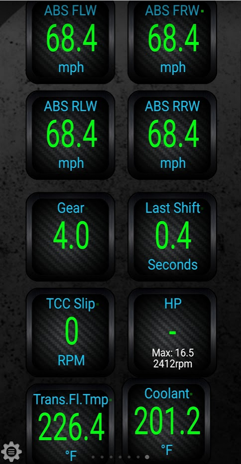

I use a cheap OBDII reader from amazon with the Torque app (I got the pro version). I believe the app is available on apple, but not 100% sure. It is a very nice app, and I am able to read transmission temps, though I needed to download a GM add-on (available in-app) to get the trans temp (you might need the pro version to do this).
I think it is a great little app that is pretty powerful. I can also read basic engine codes, but anything else (body codes, transmission codes, 4WD codes, etc.) are not available with this setup. Readings are fairly real-time, but not instantaneous (10-seconds maybe).
If you go this route I can help with the add-ons if you need it.
Here's a screen shot of one of my pages:
