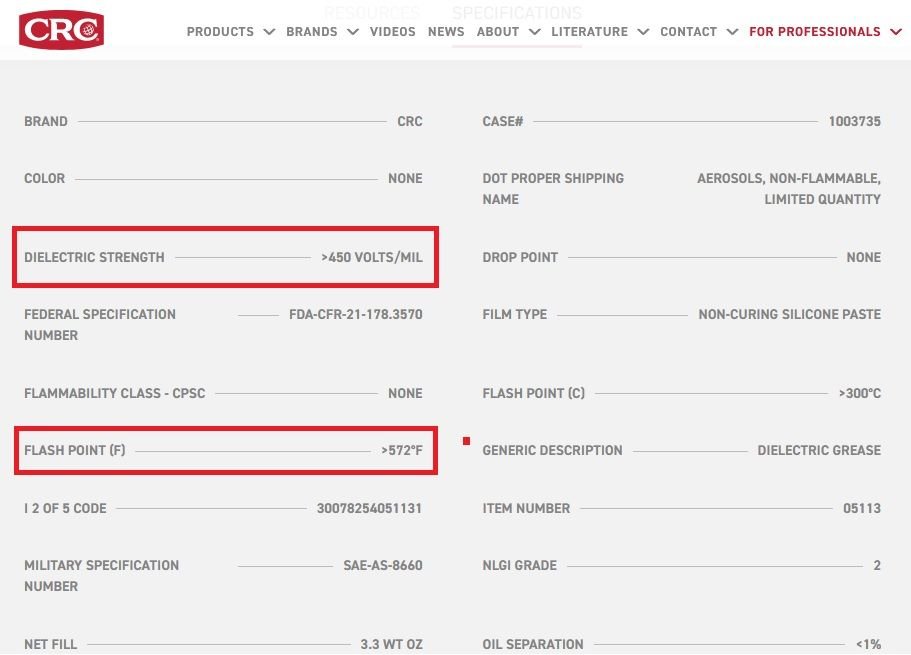

Old Oct 12, 2022 | 10:40 AM
Except when its not.
Silicone Dielectric Grease is not the same as Thermal Grease. Silicone Dielectric Grease is a temperature resistant material used for lubrication and as a sealant to prevent corrosion. Thermal Grease is a temperature conductive material used to assist with efficient heat transfer to a heat sink. Depends on which is being used and not to be lumped together.
When used properly it can protect a circuit. When globbed on like BBQ Sause on a rib ........ too much is not a good thing and its not needed to begin with.
From TheDrive:
Q: So Does Dielectric Grease Improve a Connection?
A: No, dielectric grease is not conductive, so it does not improve connectivity. It helps maintain a good connection, though.
Q: Yeah, But Is Vaseline a Dielectric Grease?
A: Dielectric grease is different from Vaseline, as it uses a silicone base while Vaseline is petroleum jelly, which is made of waxes and minerals. Don’t use Vaseline in your car.
Q: Then Is Dielectric Grease Necessary?
A: No, dielectric grease is not needed for any connections to work.
Q: Can Dielectric Grease Cause a Short?
A: No, it cannot. If anything, it will help prevent shorts.
Q: How Can You Remove Dielectric Grease?
A: CRC suggests using “petroleum distillates and chlorinated solvents.”

Doc, I didn't see any 'nots' except for the BBQ sauce comparison . It is not needed for a connection to work; it is used to protect the connection. I've seen enough corroded electrical connections to know its value.
