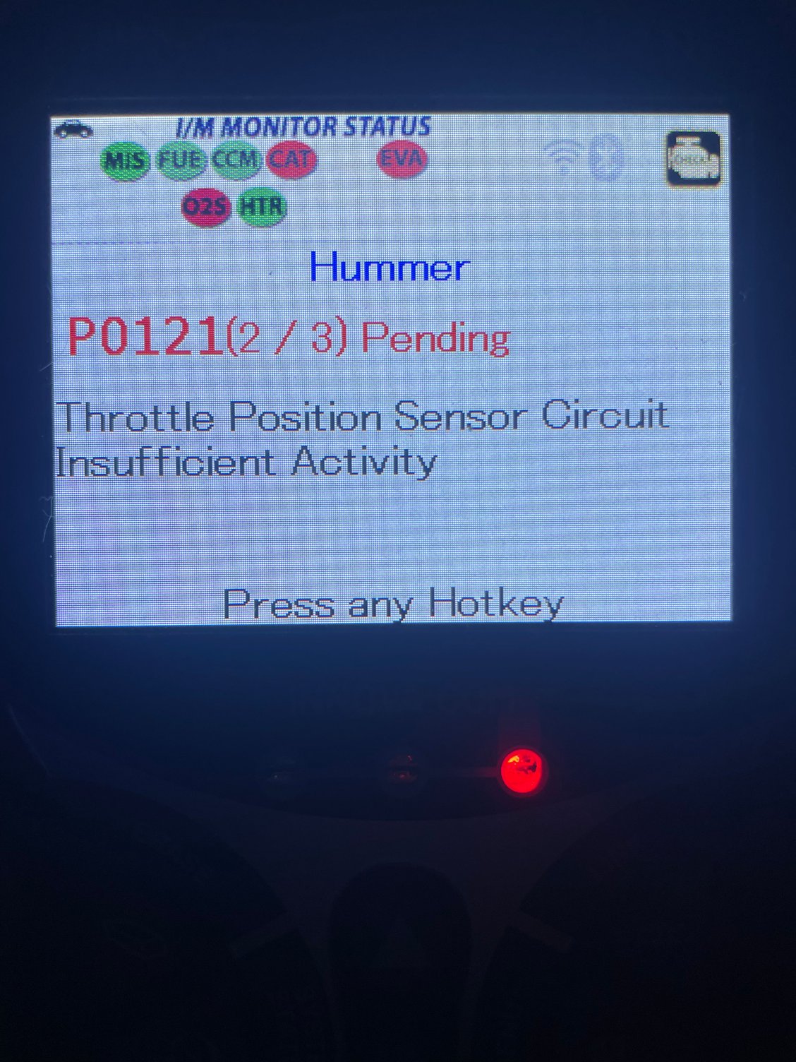

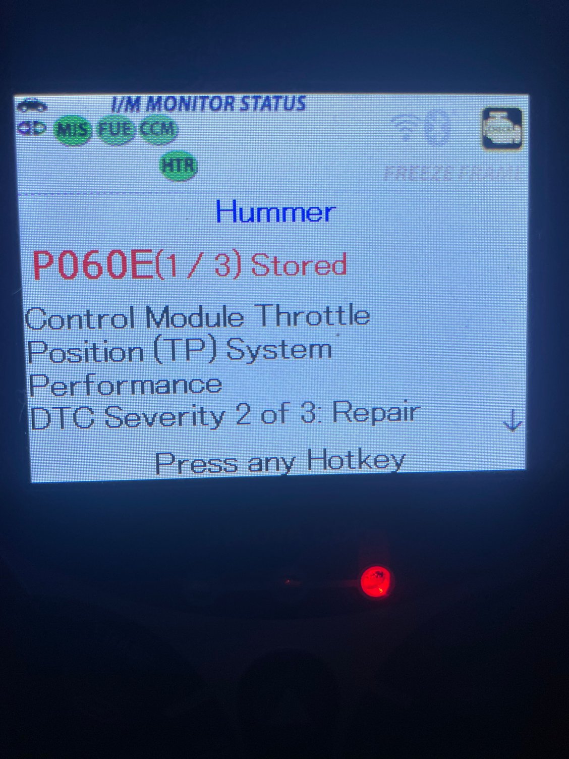

So I let it idle for about 40 min. When I started it up my scan tool said the TPS was at 12.9% and it stayed there the whole time. The idle was fluctuating between 650-700 the whole time as well. Took the truck out for a test drive and told my wife to drive it like normal we had made it about 1/2 a mile and these two codes tripped. P060E and P0121. This is the first time for the second code to pop up since I have been trying to fix this. The vehicle speed was 44 mph at 2419 RPM the TPS was at 40.0% when it entered the reduced power mode and turning off the traction control. I am about ready to pull my hair out. The pictures is what the codes are.
