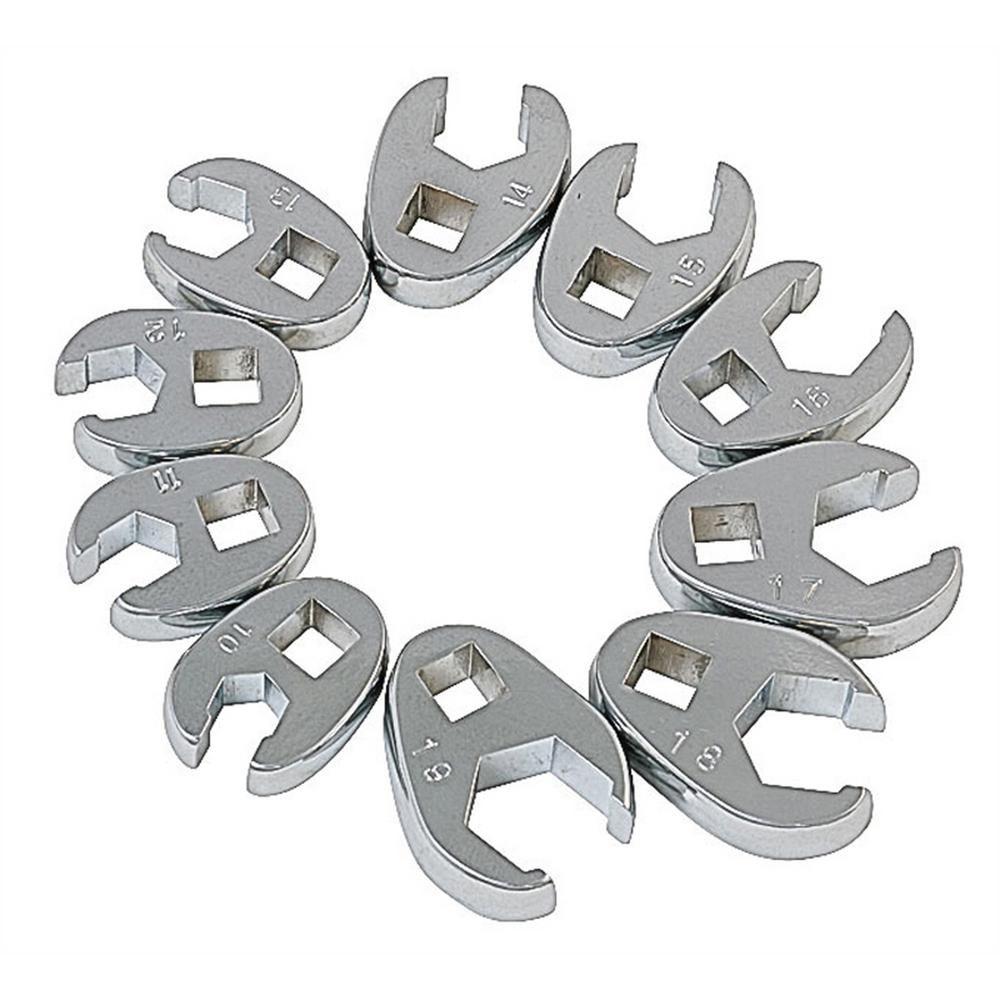

We drained the radiator and pulled off the thermostat housing...... No thermostat! That is the reason why we were only at 1/4 on the temp gauge most of the time. We also ordered a new temp sensor because.... it was cheaper than 2 gallons of antifreeze. Now for the question: How do I get it tight? I can barely feel it let alone get a tool in there. The old one came out with my fingers, I don't know why it was not leaking.
Old Jul 12, 2020 | 06:40 PM
Posts: 9,017
15mm crows foot.
Or you can modify a cheap 15mm socket:

15mm crows foot.
https://www.youtube.com/watch?v=OY5bMq6o4yk
Thanks! The old one came out with my fingers. It is amazing that it was not pouring coolant out from there

Previously replaced, without a proper socket wrench. To remove original, cut wires(just like replacing an o2 sensor) and remove with regular socket. However installing the new, you need a crows foot or modified socket to tighten. I modified a socket with a cut off wheel tool, and removed without cutting wires, and tightened the new 1 without a problem. I have thousands of socket wrenches and 1 is an H3 specialty socket.
