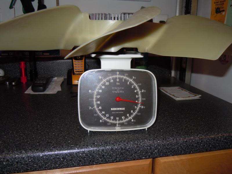

Most cars have used electric fans since the 90s, for trucks that has been a slow transition, GM started with them OEM in 2009 FS trucks. The H3 has a mechanical clutch fan driven by the serpentine belt off the crank pulley. It basically is on all the time even when the clutch is disengaged and it weighs about 6#s.
The Efan does no produce power, rather it frees up some that is being used to spin it. The Efan conversion is a solid 1 MPG boost and 5-10 HP.

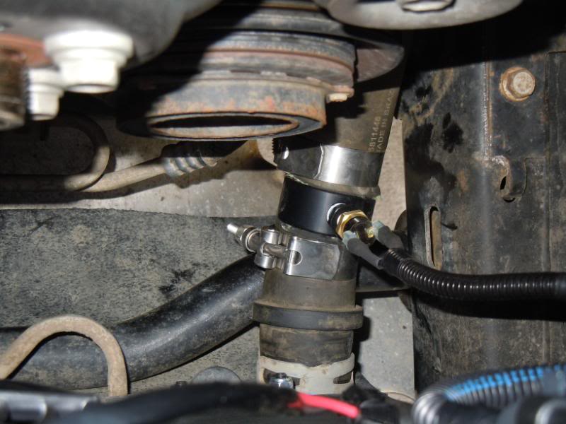

Not really, to drain the radiator in a 3 you disconnect the lower radiator hose. While it is disconnected, you cut it where you want to mount the sensor.
Here is a good look at mine.
