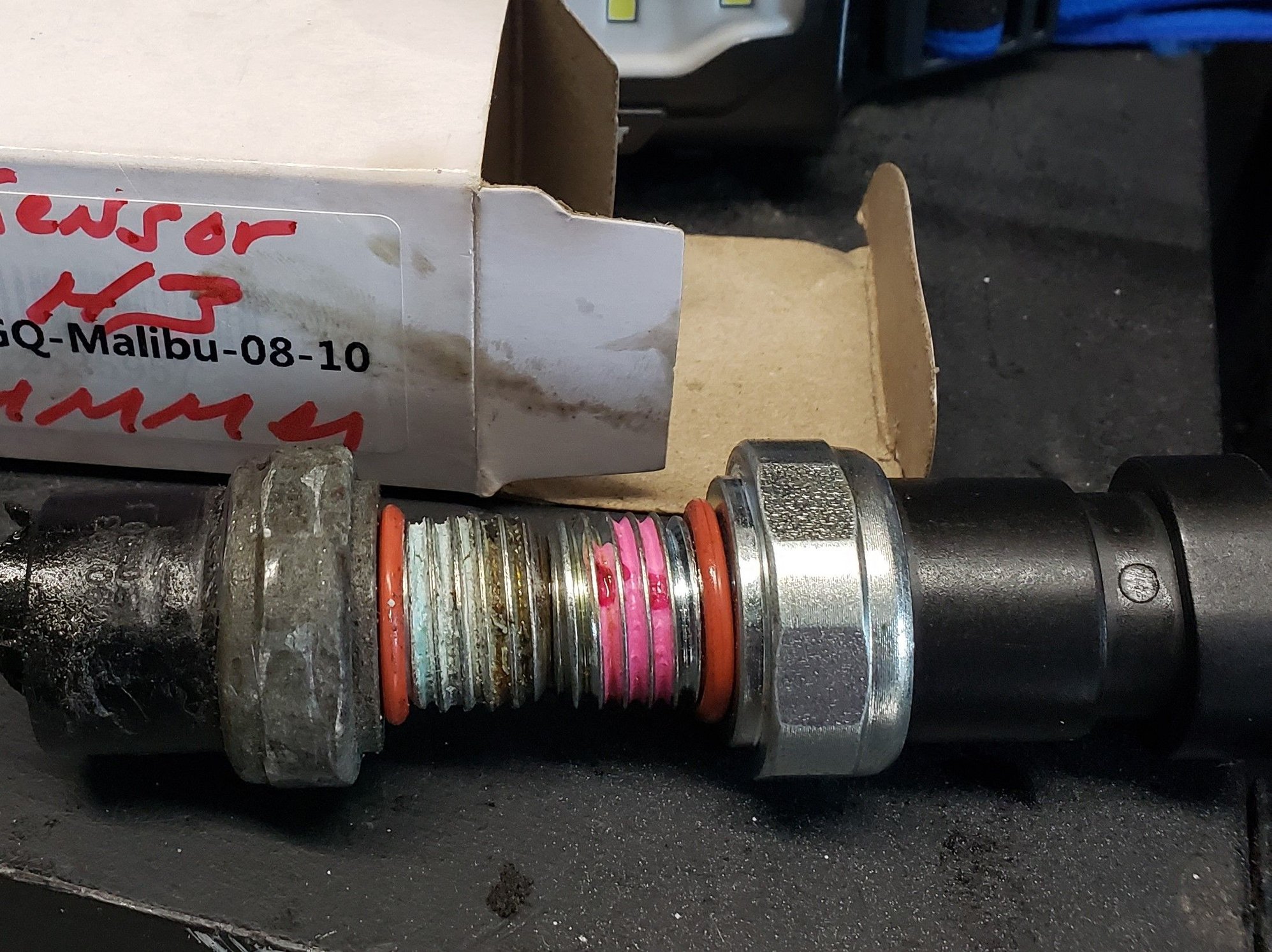

Hey Guys,
Have had a low oil alert on my 3.5 with 105K on the Od. While waiting for my garage appointment. Found a pool of oil directly under the Sensor...
Seems not only was the sensor failing on reading low oil alerts when there was none. Evidently it was signaling it was about to totally fail. So now since oil is coming out at a rapid pace.
I may have to address this in my garage or have it towed since the hemorrhaging of oil is severe. So since this is not entirely new here. I have orderd some parts and will see when I pull the
old sensor and get a new one in if in fact that is where Xactly the problem is.
Pulled the shields off and it looks like the sensor is the problem. The puddle of oil is the size of a 12 inch pancake... Ouch !

OK Boys,
So needed a 1 1/8 deep socket to get the old one off...
Had to take the end off the old one for the proper fit to remove the old failed oil sensor.
Needed this socket to put the new part in after taking the passenger wheel off to properly get to it...

The sensor looks a little like a cut off roll of pennies.
Old on left new on right H3 sensors
