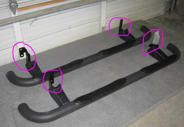

The side tube steps are usually made of several pieces attached to one another.
There is the tube.
There is the bracket, arm assembly.
There is bolts to attach tube to arm's .
There is bolts to attach whole assembly to frame.
If the arms the step fails. If the tube rots the tube falls off. If the frame rots it is more serious lol!
Old Aug 6, 2020 | 06:58 AM
So the mounts (circled) are rusted and not supporting the step?
If so, as stated before "I'll take a stab at it and say new running boards..."
It is not cost effective to just replace the mounts. You will also have a heck of a time removing the mounting bolts if the rust is that bad. Bolts will break in the frame.
