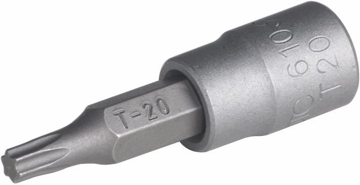

Only 1 T20 head screw, pull it out, disconnect, clean connector/contacts reconnect to check, or swap with another door switch. 5 minute diagnosis.
