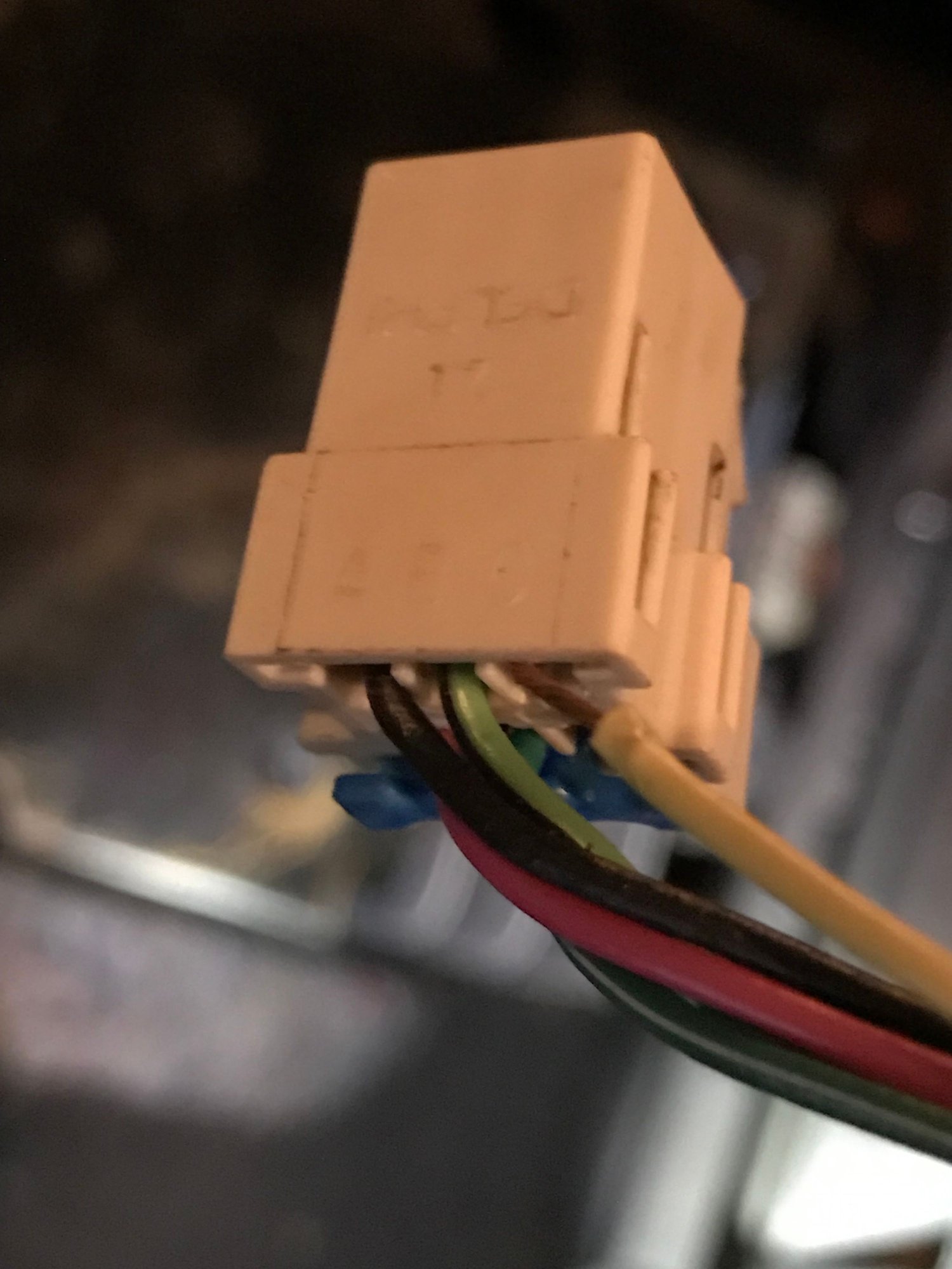

sometimes a wire breaks on the shifter from moving the shifter into the gears that controls the solenoids. in my case it was the yellow wire on the shifter.

Posts: 3,217
the break usually happens on the console shifter wires not the column itself.
here is a pic of the plug that goes into the console shifter lever with the pulled yellow wire
you have to remove the shifter handle and pop the shifter cover to get to the shifter.
