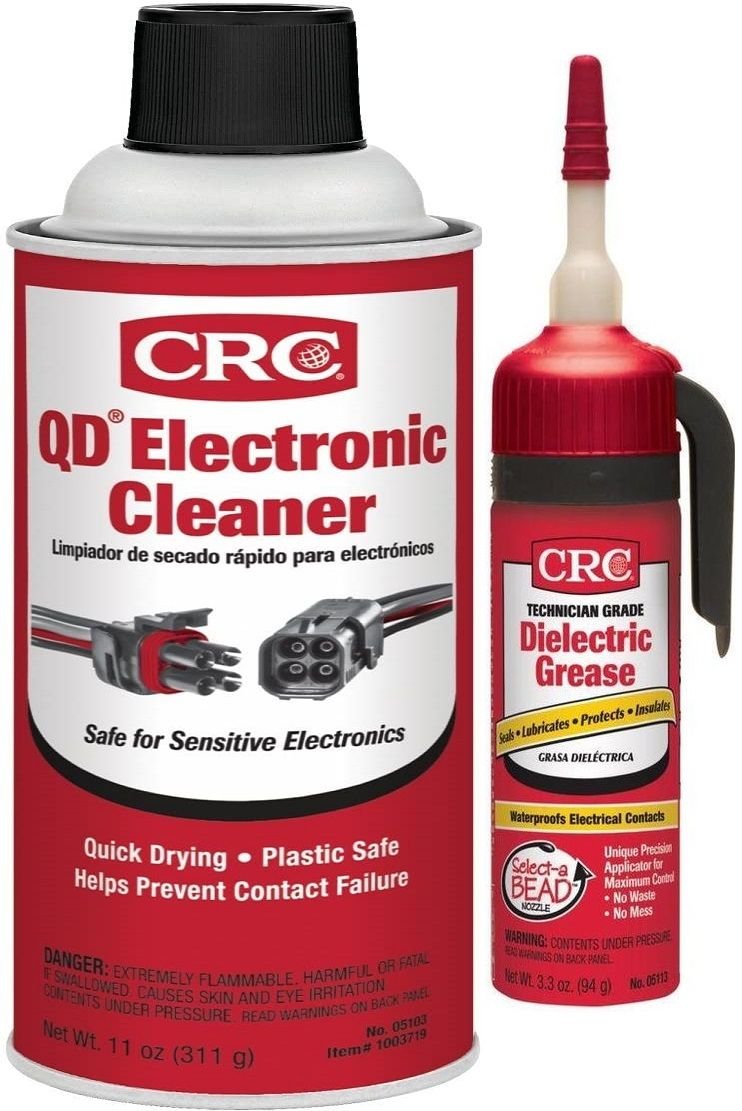

Good point. Just find the signal loss! KOEO, WIPERS ON, wiggle/reseat/rotate:connectors/relays/switch. Warning: don't leave the wipers on a dry windshield or you will cause damage to the wiper motor/transmission. When you find the source of failure, open a can & clean contacts.
