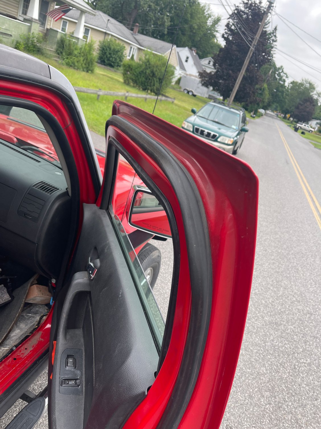

The seal is there and appears intact. I will take a picture.

The water I tested with didn’t go inside. I am wondering if it’s door seal or top panel?
I think roof drain design in general is flawed- I had to modify the pipe.
How do I tell if door seal is defective?
Could water get in from that black panel ?

With the window and door closed, pour water around the door seam, check for leak inside. If it doesn't leak into the cabin, pour water on the roof rack track and check for leak inside. Keep pouring water/or use a garden hose without the nozzle, in different areas until you see a leak inside the cabin.
