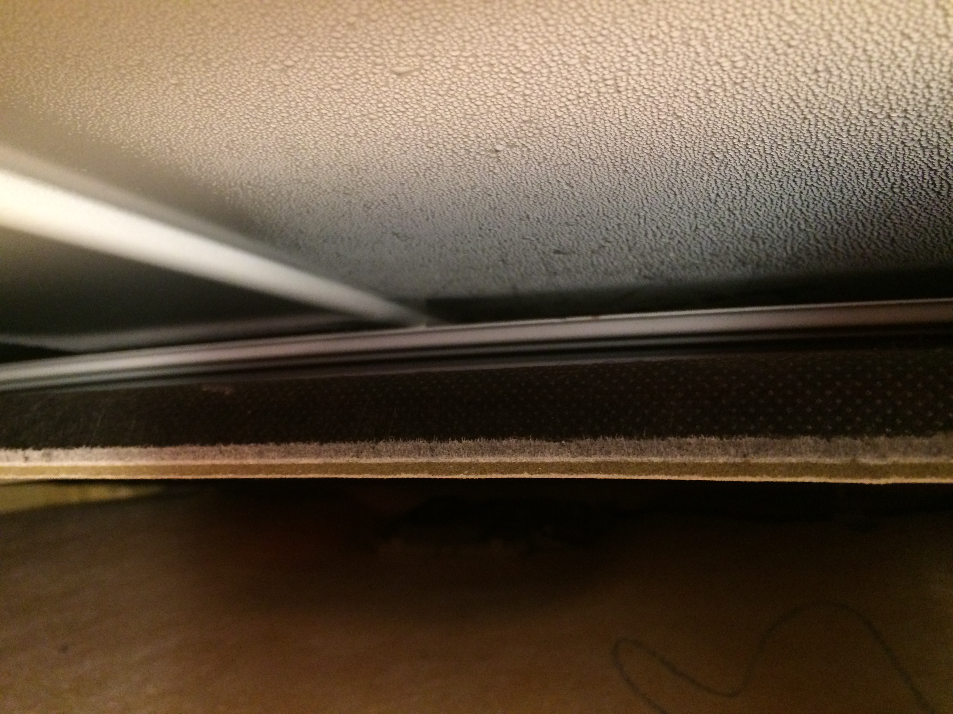

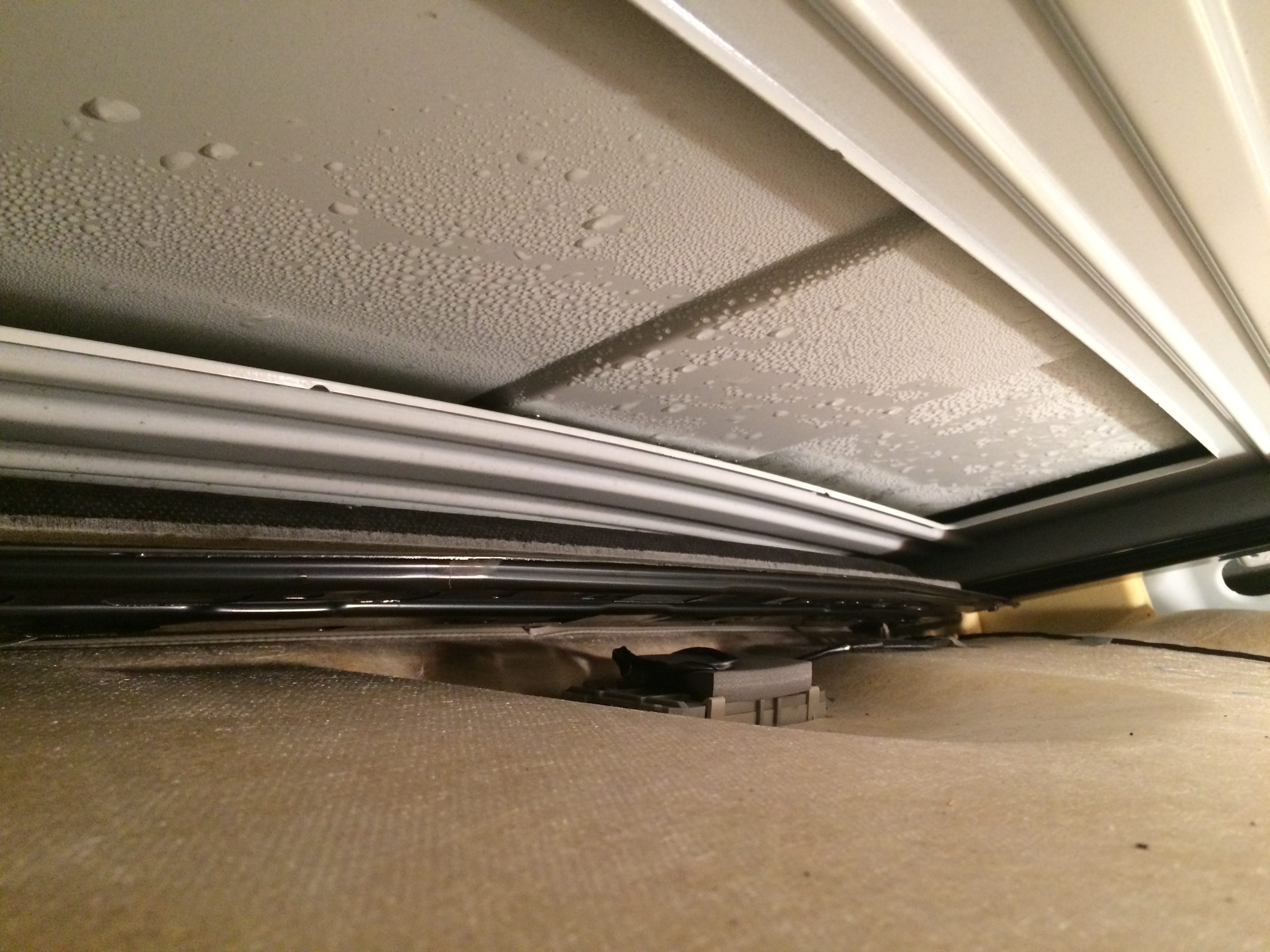

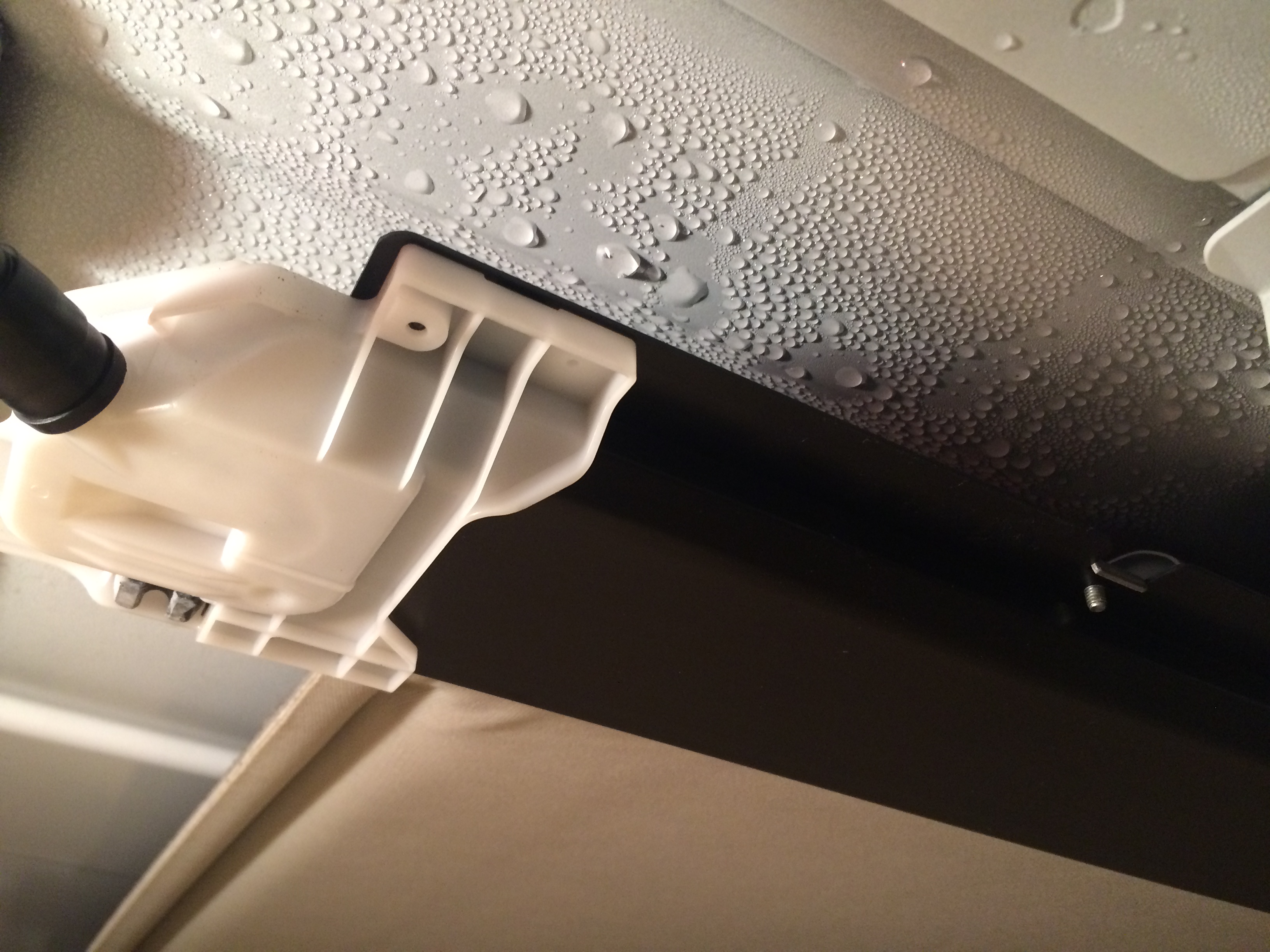

Before anyone screams use the search function, I did. Here is my issue. I pulled everything apart and cleaned the sunroof drain tubes and they were all clear. The headliner isn't wet at all top or bottom however the entire roof of the truck under (or above) the headliner has a lot of water droplets on it. Any ideas how that happens? I will upload pics if I can. I am doing this from my phone. Any ideas or help is greatly appreciated!

It appears to be condensation on the roof. Probably caused by cold vs hot and humidity. The water on the floor is evaporating and condensing on the roof. Find out where the water on the floor is coming from. Just remember that water flows downhill and can puddle up in low spots. Take the vehicle for a drive and the acceleration and deceleration can cause the puddles to empty to another location. Start by determining the wettest spot and moving up. Good luck. It will not be easy and you may have gut most of the interior. The H20 can come in through seams, seals and bolt holes. As well a blocked drain for the HVAC can cause water on the front passenger side floor.
