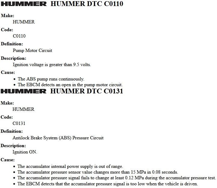

I found this forum trying to get answers to my problem. My H3 got stuck in the snow and while trying to plow threw it I lost my power brakes. I have manual firm brake pedal but no power brakes so stopping is very hard. I did get out and into my garage. I crawled under to see if i ripped off any wheel sensors etc. and everything looks great and no issues found. So i ran some codes and got c0131 and c0110. i checked all the fuses and they are ok. Not sure which or if any relays to check. I went to the big plug on the Power brake module and it has power and ground. I can also here it doing something at the round sensor on the right side. Totally lost on what to do next. I cant get it to a dealer because its 250 miles away.

is there a component that would make these two codes come on? Is this related to being stuck in the snow as everything was perfectly ok before with no codes for months.
BPMV (Brake Pressure Modulator Valve)
