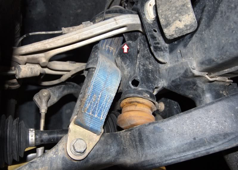

Old Mar 28, 2011 | 08:40 PM
  #57
Bunger's Avatar
Joined: Sep 2009
Posts: 1,356
From: Connecticut
Originally Posted by drtom
whats the difference between a stock h3 and one thats cranked up. in both cases the shock would stop the suspension at the same place,,? right. it seems this protects the half shafts,huh.
so dont longer shocks let the wheel fall down further,risking the axel?
No, there is a metal stop limiting the upper A arm's travel.
If you crank the T-bars you will get past the stock shock's travel length and possibly damage the shock if it's at max extension. It doesn't matter how much longer a replacement shock is, it's travel is limited by the hard stop.

Old Mar 29, 2011 | 11:04 AM
  #60
i found this in my book,,thot i saw it b4.
sorry for crap pix ,i shot it quik,sometime i cant figure how to get it in here.
looks like the front would fall apart without the shock
Don't believe everything you read!
There is a metal stop for the upper A-arm built into the "bump stop" mount!
Photo taken from CHO, photo by HUNNER
