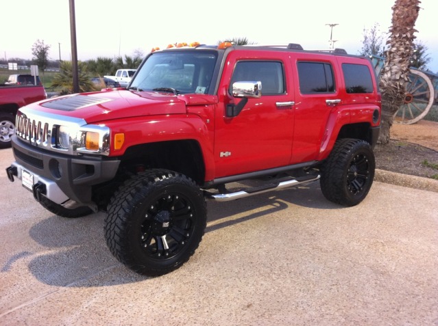

rford426's Avatar
Joined: Mar 2011
Posts: 18
20" Kmc Monsters with pro comp 35x12.50x20

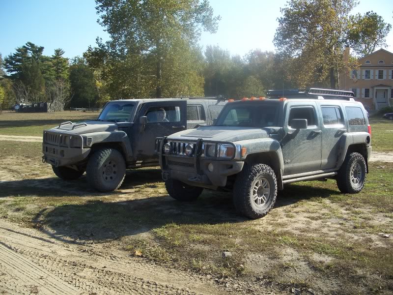

Bunger's Avatar
Joined: Sep 2009
Posts: 1,356
From: Connecticut
Originally Posted by Jay035
Thanks preciate it! can you post pics of yours id like to see it
My truck is on the right, leveled with just the torsion bar adjustment, 23.5" bottom of fender to center of wheel.
Same with the truck on the left. I have 33" tires, the other truck is running 35" tires.
Here's another
