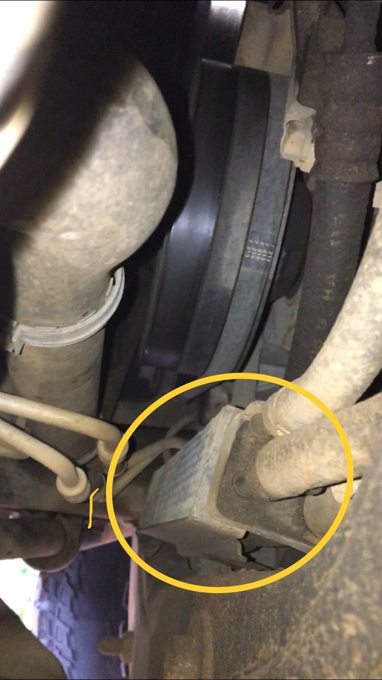

I do not see a code for a trans cooler if there is one, unless "Z68" includes it. Do we have anyone that can tell me more about that "Z68 code? I did see a secondary cooler low and behind the radiator. I'll guess for now that it's a trans cooler. I'll check tonight to see where the lines go (to and from). If that's not one it then I will add one.

Here’s a pic of what I think is the additional trans cooler. Can anyone confirm what it is?

What you have circled above is the power steering cooler.
No "extra" trans cooler with the tow package.
You will have to install an in line plate style cooler in front of the radiator or remote mount a totally separate cooler+fan.
