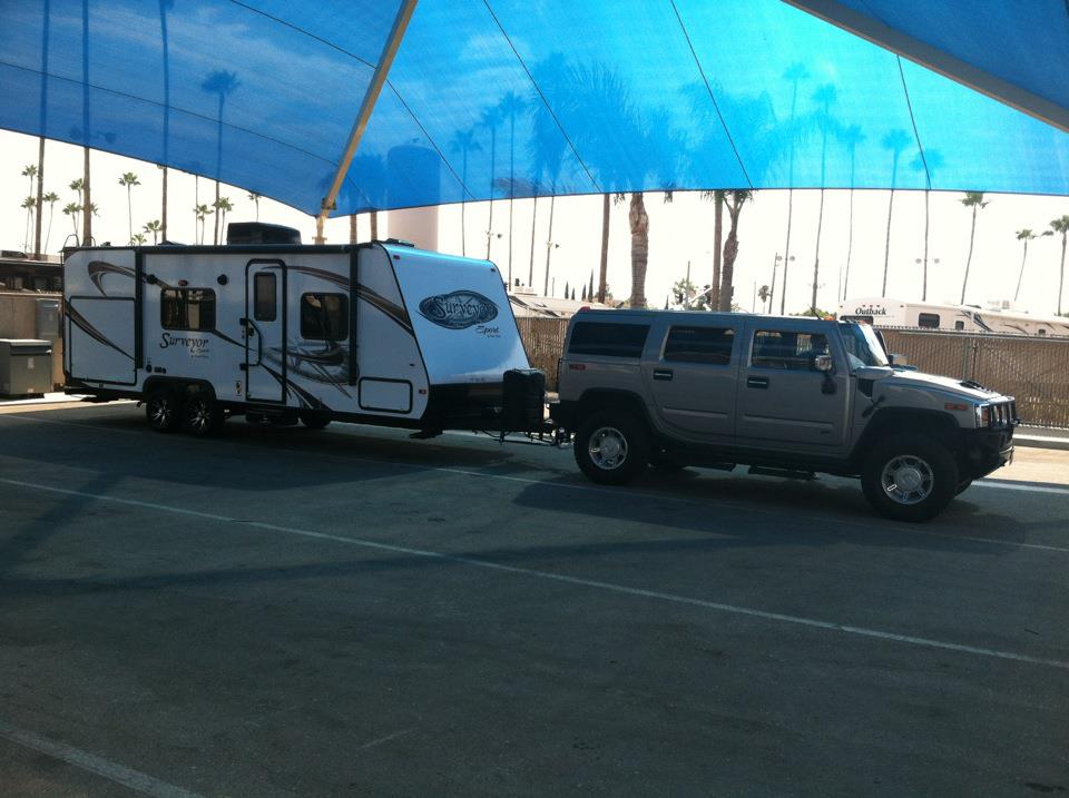

Just an FYI, I had the same issue with my trailer being alot heavier than the sticker stated. After some research I found out that the sticker does not include all the options on the trailers like; spare tire, refrigerator, heater, water and waste water weights, awning and any other optional equipment that you may have.
I just replaced my 96' aerolite 21ft. travel trailer with a 2013 forest river surveyor sp240 sport. the sticker stated 4900 lbs. but when I weighed it fully loaded with water and all my gear I was just under 7k. My max tow capacity is 6800 but I have upgraded my trans and am in the process of replacing my fan assembly with a dual electric setup that I bought off of ebay. should receive it today. I'll post if it really help lower my trans and engine temps while pulling uphill.
Old Sep 9, 2012 | 10:36 AM
H2CANEPADESIGN's Avatar
Joined: Jan 2011
Posts: 614
From: N. Hollywood, CA.
Size:  78.2 KB the Elecric fan didn't help the tempuratures at all, am going to replace radiator with larger hi-performance setup. will advise when I take out a second mortgage to allow my addiction to continue.
