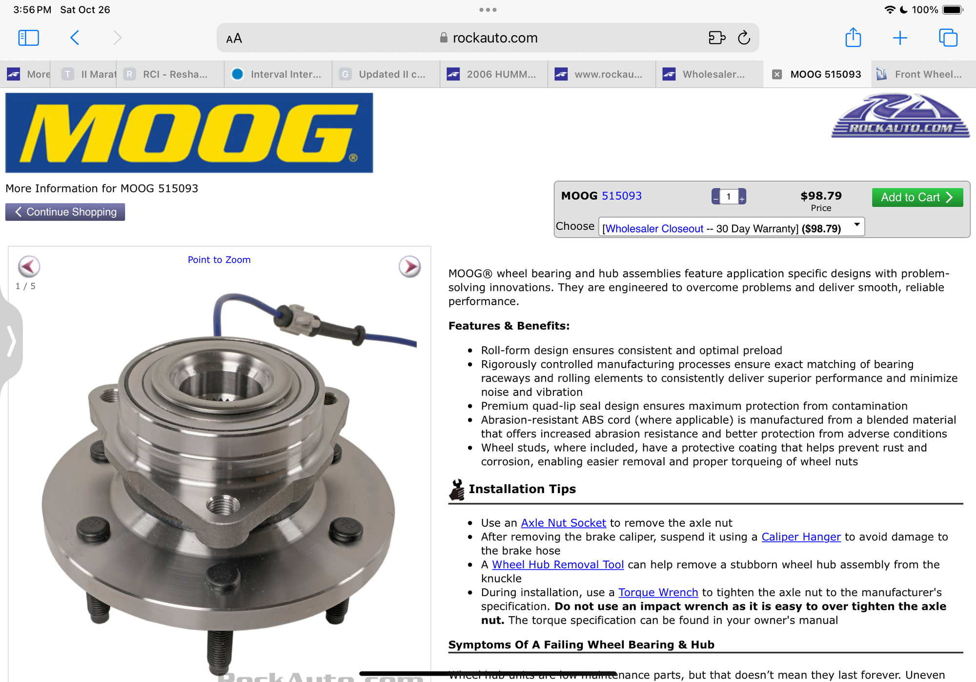

What do you think of these — they are $50 off (Normally $$149) and usually think of MOOG as a decent brand.

What do people think of the Moog Hub quality and discounted price?

The discounted price feels great until the second time you have to replace hubs. Moog makes OK parts for cars, I am not overly excited about their truck stuff. They will work, the question is how long will they last.
