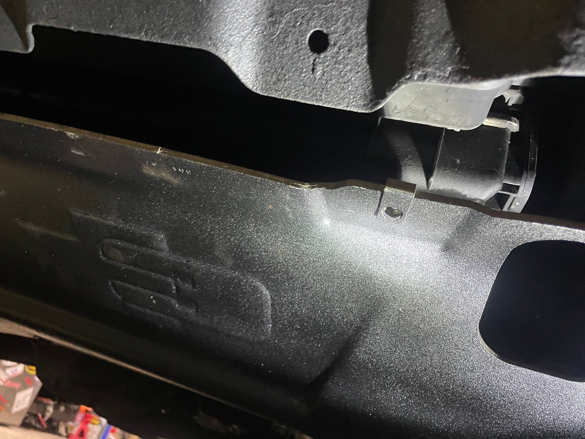

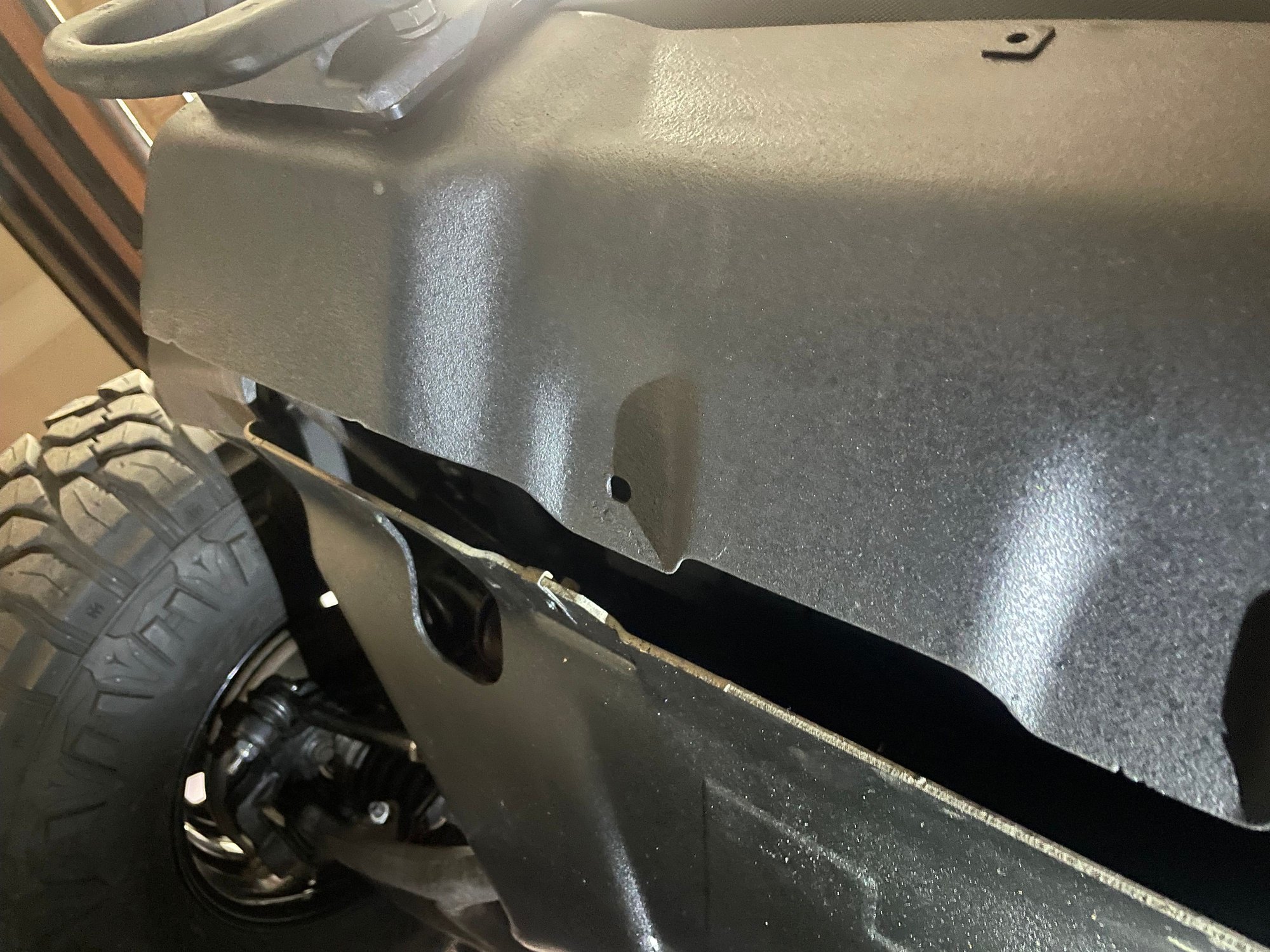

Just wondering if I’m missing something here, are there different size front skid plates for the h3 and h3t? I pulled one off a h3 but the front part doesn’t fit on my h3t. Or is the bumper diff. Sorry the pics suck since I had no room to take them in the garage.

Thats correct they have different skidplates based on year. 2008+ had a crashbar installed above skidplate to stop the H3 from running on top of small cars in the event of an accident. Some people (myself included) have swapped to the older style for a little better approach angle which requires a new lower bumper section from a 2006-2007 as well since they are a different shape. If you get a ARB bumper they only fit a 2008+ front skidplate.

Gotcha, yeah, it was a 07 i pulled the plate from. Looks like the 08 and up plates dont have the H3 marking on them. 😢

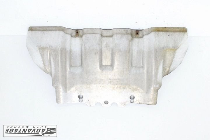

Old Apr 20, 2026 | 09:36 AM
06/07
08-10
Old Apr 20, 2026 | 10:21 AM
Me 2's Avatar
Joined: Dec 2025
Posts: 70
Thanks again Doc Olds, definitely longer
