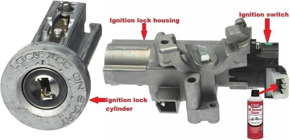

Yes, your remote start was programmed to the ignition switch that you decided to replace, not the new replacement.
If you would have came here first we would have told you that you do not need to replace the ignition switch for Passlock failures, but instead clean the ignition switch and its connector.
Pic courtesy of hummerz

Old Apr 21, 2026 | 09:22 AM
Posts: 3,203
or clean your old switch and put it back

Hosa CAIG Laboratories D5S-6 CAIG DeoxIT Contact Cleaner, 5 Spray, 5 OzIs this a good electrical connection cleaner? I have this already and wanted to check before I order the CRC brand that is suggested here.
Old Apr 22, 2026 | 11:57 AM
Posts: 3,203
Deoxit should be fine. it works better than the CRC hence the pricing difference on them.
