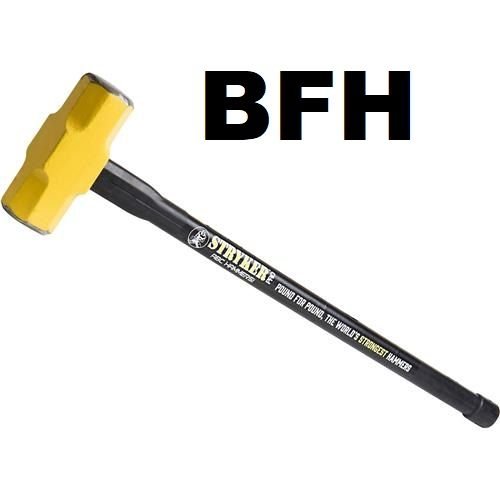

Old Jan 27, 2022 | 12:03 PM
Echelon's Avatar
Joined: Apr 2017
Posts: 66
wouldnt that be a BFH? not out of the question if i cant find one

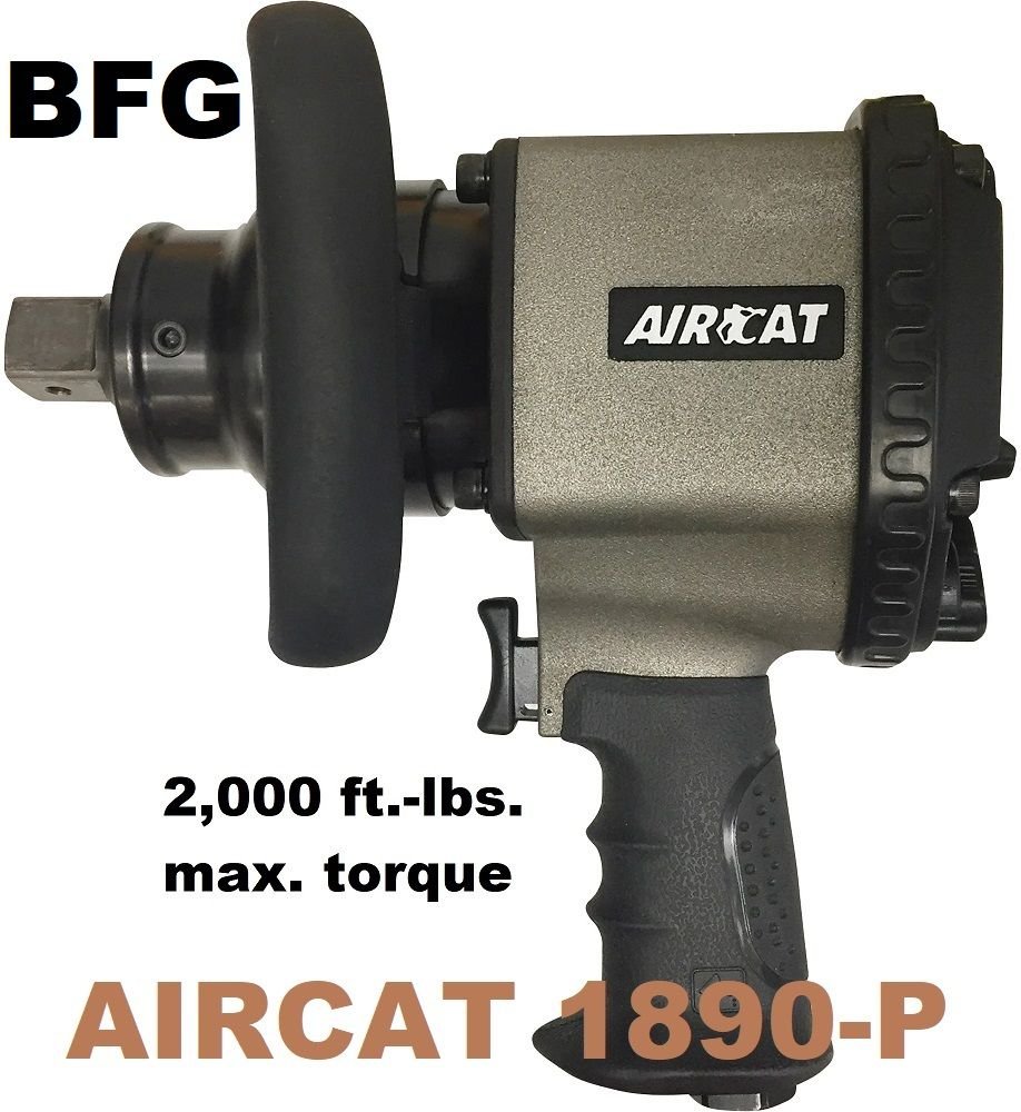

Old Jan 27, 2022 | 01:46 PM
Posts: 9,047
i used a BFG on mine (BIG F***ING HAMMER)
BIG Fv¢KING GUN
Old Jan 27, 2022 | 04:08 PM
Posts: 9,047
Yes, the BFG only comes out when a bolt/nut is not cooperating.
