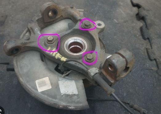

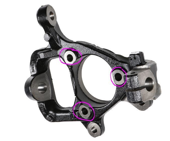

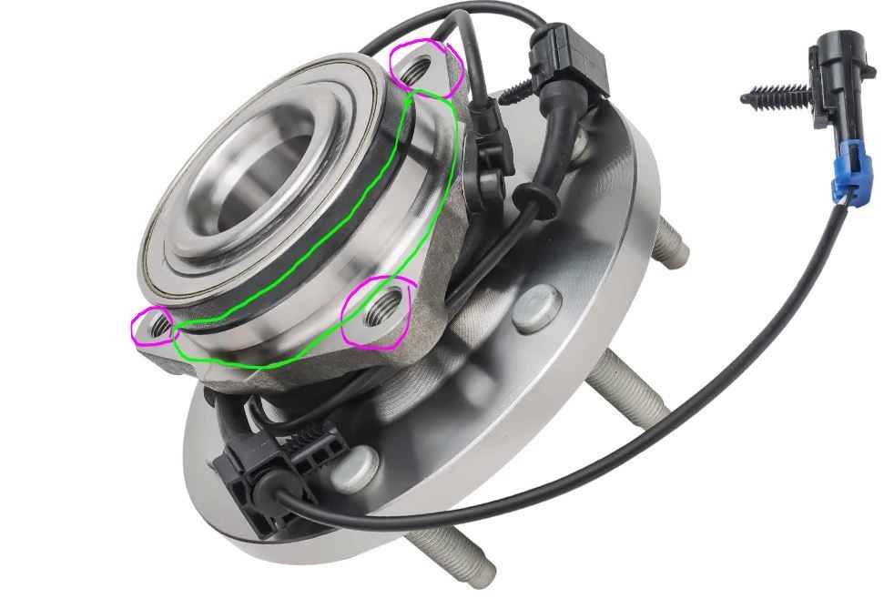

Not sure what "plate" you are talking about. The dust shield?
The Knuckle and hub are definitely separate parts.
The Knuckle has 3 bolts that attach the Hub PINK to the Knuckle.
The Hubs will rust/weld themselves to the Knuckle on the mating surfaces GREEN.
Soak with PB BLASTER or similar penetrant use a press or a BFH and Large socket to separate the 2 rust/welded parts.
