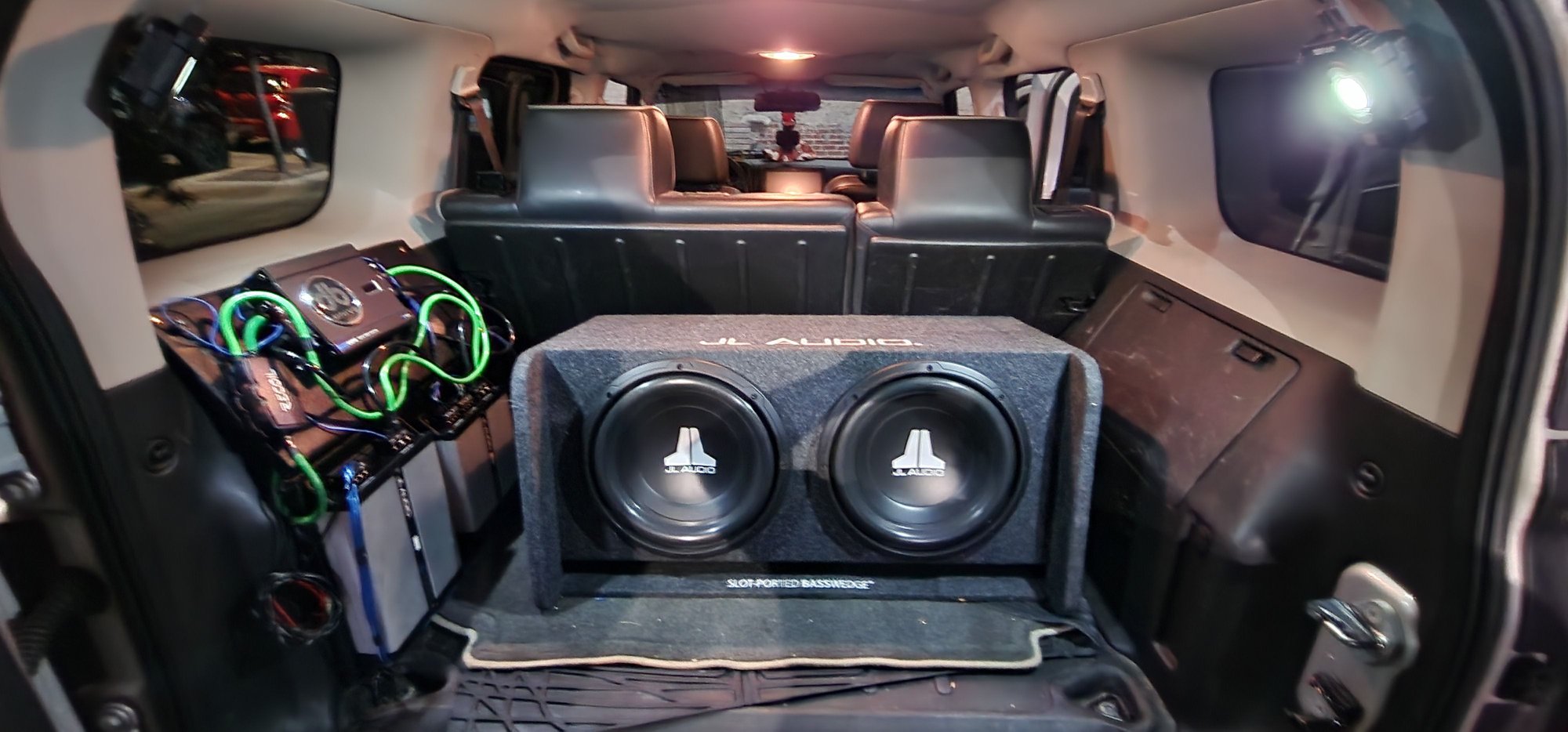

These questions posed represent the last items to be done to finish my Hummer. Ive installed an entire JL Audio sound system, a streaming rear view mirror ( it attaches to the existing mirror, but not well), replaced my head and fog lights with LEDs, and changed the spark plugs/ coil packs. If you know the answers , great thank you for your help. I've had my Hummer for 2 months now. I couldn't afford one back in 2008, so yes, I'm sure some...of these questions have been answered. Despite doing several searches, I could not locate the answers I need. So please, if you a blow hard hummer God who's only purpose here is to inform of me of how big your _____ is..DONT!! Most people don't have the means to buy the latest model of anything, but when they are able to get a Hummer, they come to forums like these for help and advice..not a tongue lashing or to be put in there place by a power hungry , entitled thug. I'm 49 years old , a successful

I WAS, going to jump in feet first and answer all of your questions with examples AND links. BUT, after seeing the atrocious wiring/amp/sub install, reading your diatribe, insulting the size of my ***** and how successful you say you are I decided not to assist you.
Old Nov 20, 2023 | 04:36 PM
Posts: 9,015
Originally Posted by TAINTER
BUT, after seeing the atrocious wiring/amp/sub install, .
X2^
