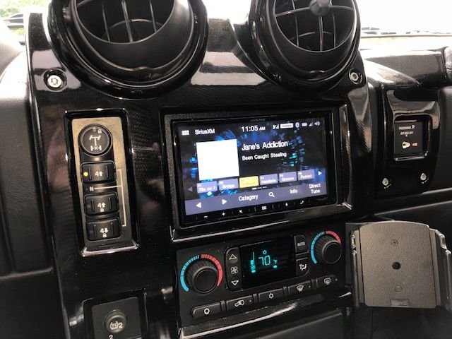

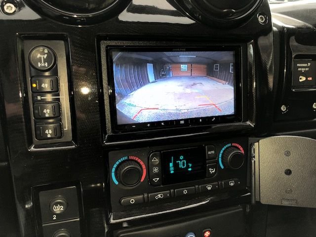

I finally fought my inner OCD and replaced the stock navigation with a Alpine 650 (shallow depth) with apple car play - added a new rear camera to the alpine and now have Waze for navigation, Bluetooth, and a rear view cam I can see out of.

If you keep - go with the alpine ilx-W650 - it has apple play, (so you can use Waze and Google Maps), front & Rear camera inputs, XM ready, USB stick, USB input, etc- and (the biggest plus) is that it is less than 3" depth!! that means all your adapters, steering wheel controls, cabling etc- all tuck behind the stereo without molesting the truck! its 100% easily reversible for the purist down the road & it looks like it belongs in the rig-

That looks good. Does it use the existing XM module? What about the existing backup camera wiring? Are you able to access it under the dash or did you run a new camera?
Those carbon fiber overlays look good as well though I favor the burlwood ones. Are yours actually replacement parts or those laser cut stick on things?

The dash is the factory carbon fiber look that was standard on the special editions- much better than the regular dash finish as that easily gets scratched and worn. This factory finish is pretty durable to wear. So to clarify, its not an overaly- all the dash pieces are coated to this appearance.
You install a new XM module and you can use this existing XM antenna (behind the glove compartment). I ran new camera wiring since I had the dash all open, came from under the rig and through the grommet for the transmission shift cable and straight up to the radio. Its a clean install.
