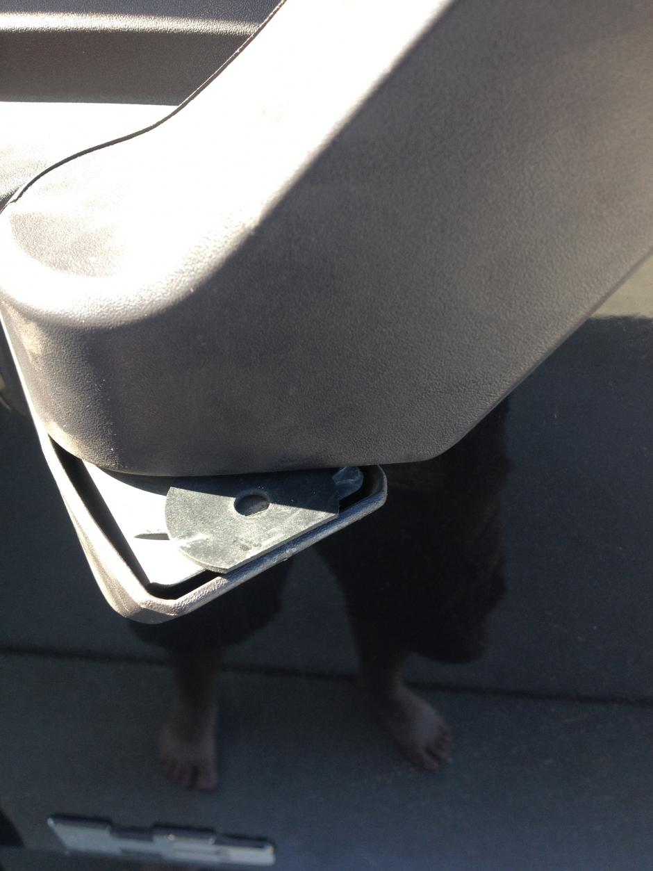

Just had the same thing happen today. Did some looking around, sounds like the plastic in the pivot point of the mirror goes bad. You can tell if you can wobble the mirror housing by hand. No way to tighten it from what i've read. I folded mine in, placed a thin rubber washer on the lip (trim the end so it doesn't stick out) then fold the mirror back out. Solid again. Beats $200 for a new one. If your's is still under warranty, which mine is not, it should be covered.
Attached Thumbnails Driver's mirror vibrates-img_0563.jpg   Driver's mirror vibrates-img_0564.jpg
maybe a piece of weed whacker cord pulled in, wrapped
