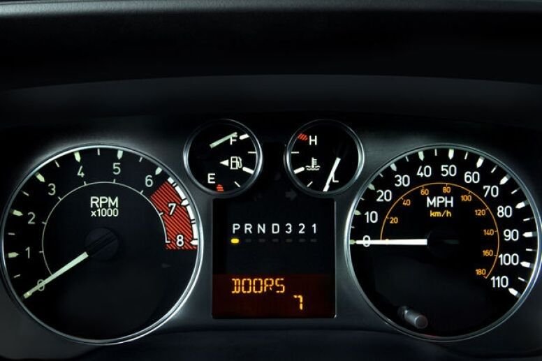

4l60 in a hummer h3 alpha. tried new prndl switch , new cluster. only P N 3 1 light up, R D 2 will not illuminate on dash. does that sound like a ground from the prndl switch. Trans operates fine, fluid is full, only starts in park and neutral like it is supposed to. Goes into each gear perfectly.

It could be ground. Did you clean w/ CRC Electronics Cleaner the connection for the new switch and harness end connector?

Appears to be an alignment issue on the switch. Easy check, KOEO, while holding the brake pedal, slowly shift from P to 1 while observing dash prndl indicators to light.
Tried that too, no dice.... contacts clean, there may be a fault in the P circuit as that is the only one that that alternates signal that would cause this issue.Transmission Range Switch Signal P
