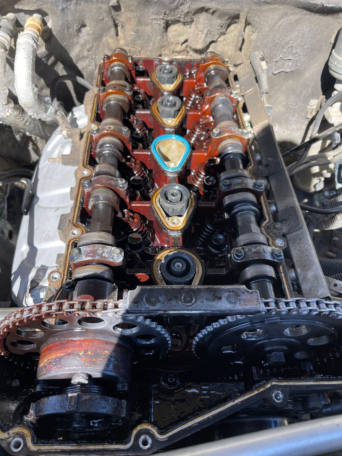

Originally Posted by NolesFan26
Once it got warmed up with the temp gauge halfway PSI dropped to around 12 but the RPMs stayed the same. It’s sitting a little above a quarter, I’ve been to scared to drive with the tick I didn’t want to risk damaging anything internally. So it sounds like it needs a new oil pump, would that also affect RPMs?
NOT the pump when you have 30psi at 900rpms! At operating temperature, normal oil pressure at idle is 10-15psi.
What type/weight oil inside the engine?

So once it warmed it it hovered around 12 psi but 800-900 RPMs I throttled it some it reached 2000 RPMs and that’s when the knocking kicked in..
Old Feb 19, 2022 | 06:02 PM
Now a knock?

Sorry, it’s a tick..

removed the valve cover, a bunch of sludge build up on the cover but there is some milky color on the timing chain components and the actual valve cover.
