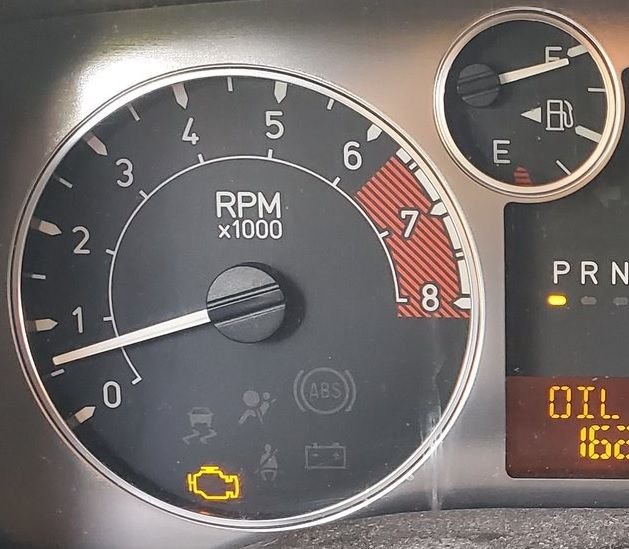

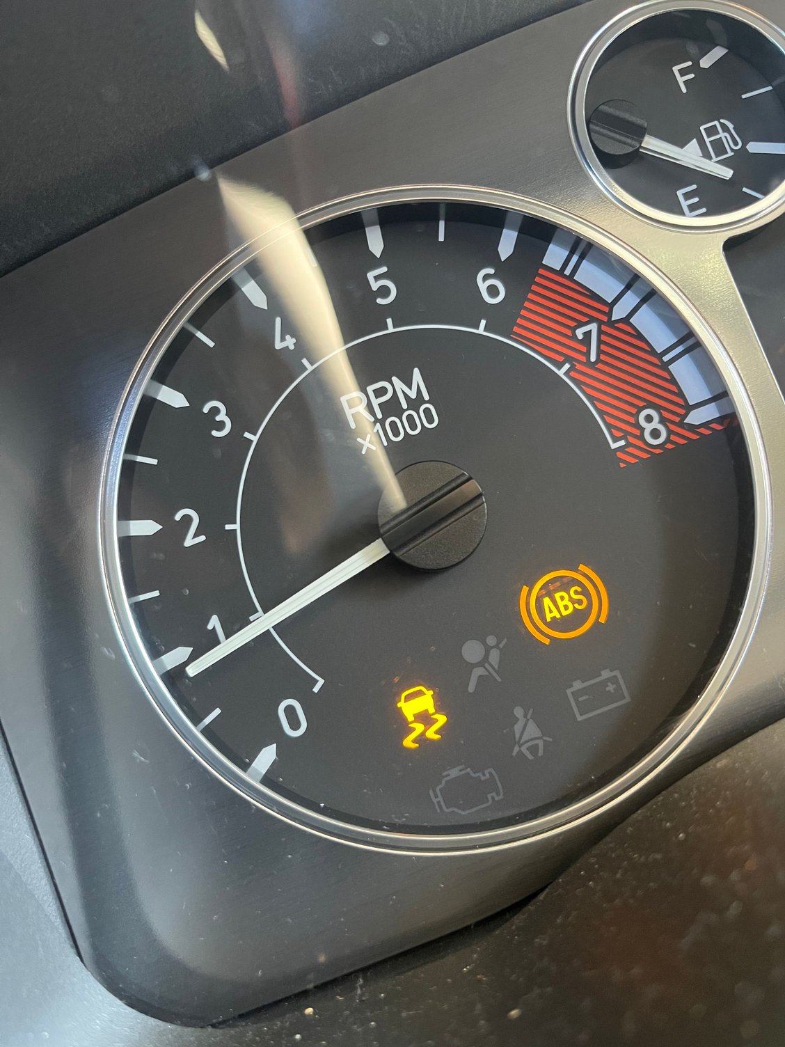

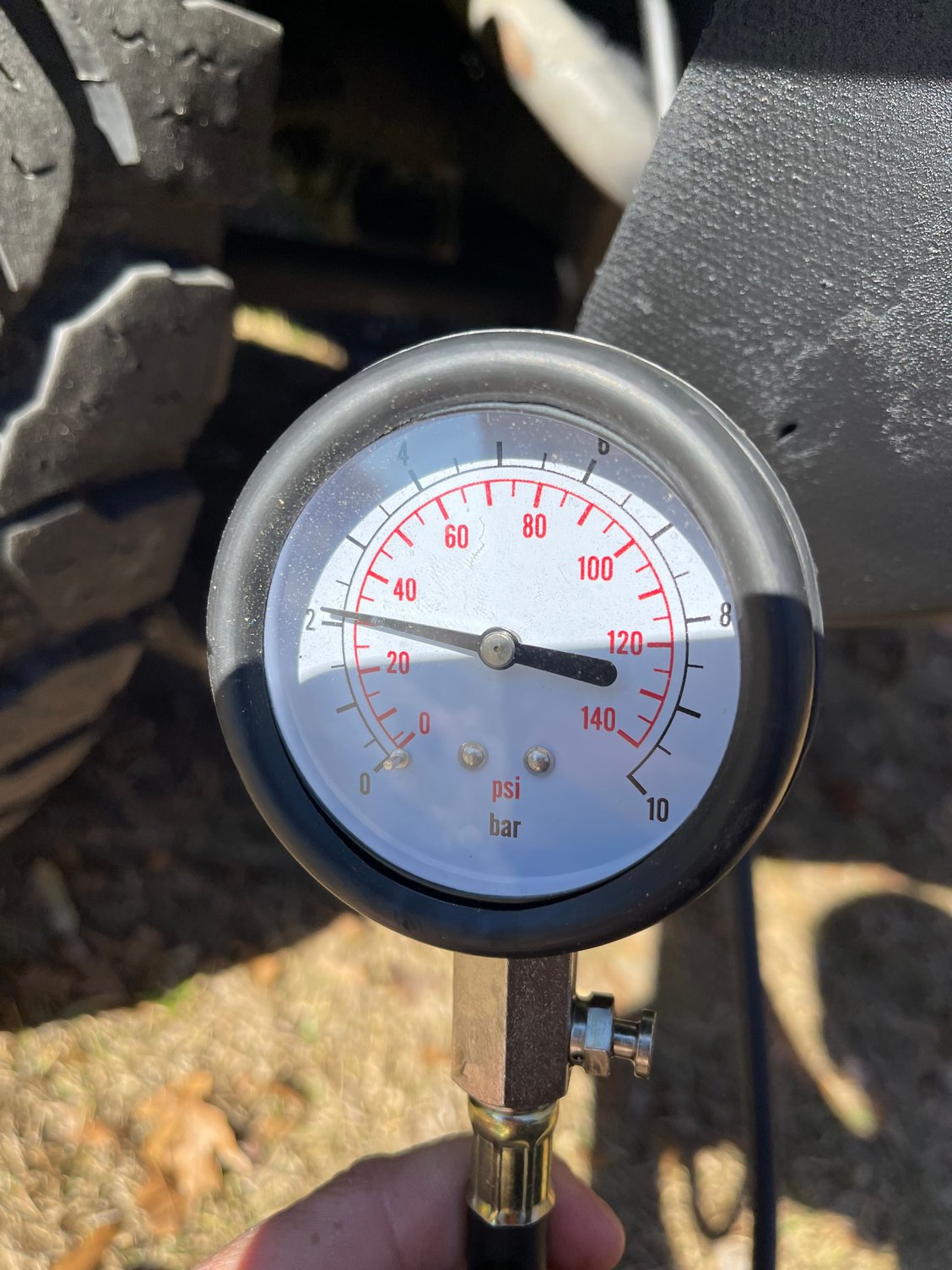

This is what it pulled at idle. It was bouncing around that focal point.
This is the RPM at the psi it was pulling at idle.
Old Feb 19, 2022 | 03:23 PM
Idle HIGH /LOW fuel. Btw, normal oil pressure at idle should be somewhere between 20 to 30 PSI.
Idle should be around 600rpms and fuel level should never go below 1/4!
oil light and constant warning chime

Once it got warmed up with the temp gauge halfway PSI dropped to around 12 but the RPMs stayed the same. It’s sitting a little above a quarter, I’ve been to scared to drive with the tick I didn’t want to risk damaging anything internally. So it sounds like it needs a new oil pump, would that also affect RPMs?
