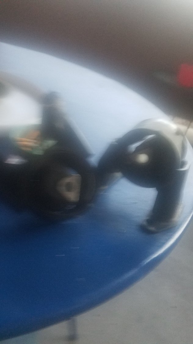

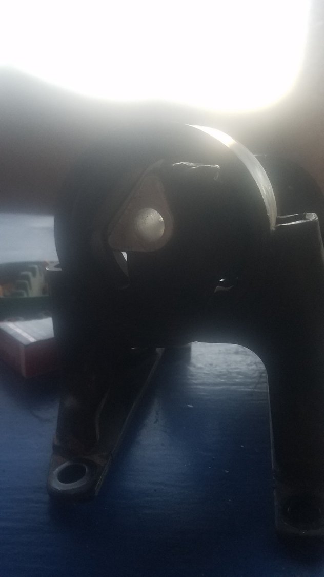

Things Ran 100% better for about 5000 miles, then I start having a lot of vibration issues and the engine starts stalling again. I pop the hood and have my brother stand to the side to look at the engine for me while I brake press the truck and tap the gas... I really didn't need him standing there because I can see from behind the wheel through the hood opening that the entire engine jumped to the right (passenger side)... like trying to jump out of the engine compartment like a huge jump!! I climb under and take a look at the motor mounts and they look shot... I can see cracks in the rubber and the light going through them. I changed out the motor mounts which I purchased through GM. The reason I paid more for the OEM Mounts is because I did not want to have to do this job again... not that I don't trust AutoZone's Duralast lifetime guarantee but anyway you know......So changing the motor mounts was a pain in the *** for me but it was definitely worth it because it's really helped, no more vibration and the engine is running better.
