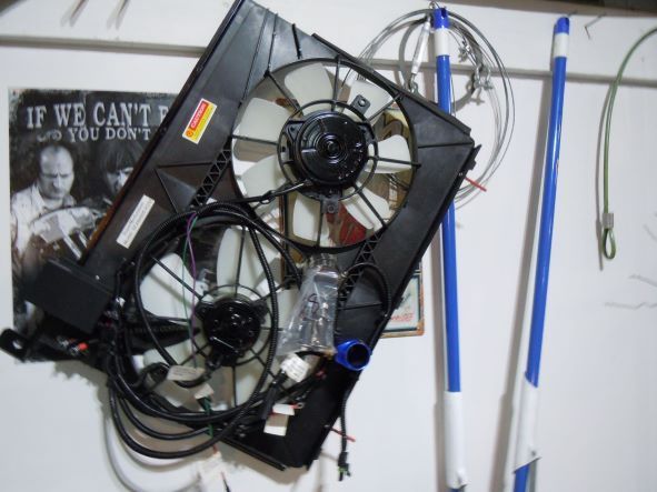

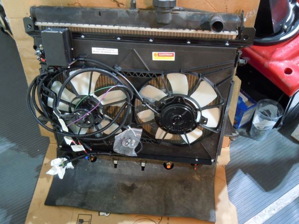

I ran one of the early PCMofNC Efan conversions on my 07 for many years, it worked perfectly but its single large fan was loud when on. Not really too bad since in MI there are months the temp is low enough it never needed to run. I still have it for a back up just in case. They have made a couple improvements, like shroud flappers to let driving air through a greater space than the old shroud panel did. I bought some flappers and am prepared to cut them some spots to install if needed.
On my 09 Alpha I installed a SuperModulation Sfan4500 with digital controller. Much more quite that the PCMofNC Efan as the Sfan 4500 has two fans in a plastic shroud spinning opposite directions and the controller ramps up the speed as heat requires and can run at a lower RPM to maintain water temp without the howl. Been perfect for the last two summers and the start of this one. I would do it again.
