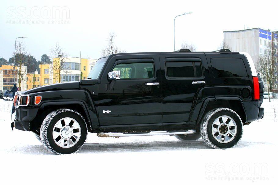

Hello everyone, just bought myself a 08 Hummer H3 176k and its awesome. When I bought it the dealer said that the only issue is the fan clutch? can be very loud for a few mins during driving. Then it's good. Should I be worried about this.

I spy with my little eye, that is an X trim, nice! Similar to mine

tha is for the advice, yes Xtrim is a beauty
