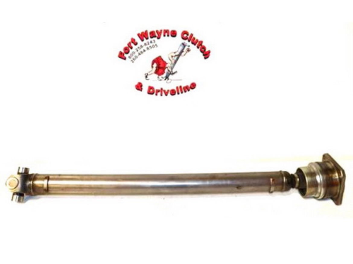

Update.
I ordered a new complete front driveshaft from Fort Wayne Clutch & Driveline in Indiana. I called them and spoke with Steve who coincidentally has a H3 himself. Their built in house driveline was 1/2 the price of a GM driveshaft on Rock Auto. Notice in the pictures below their PN# SKU # is the same as the GM OEM PN # as they make them to OEM specs with OEM or better parts.
They offer a new built to order complete driveshaft that has a Spicer front u- joint and either the AAM (OEM) or Dana Spicer CV joint. Current they have not been able to get the AAM CV joint, so they built my driveline using the Dana/Spicer CV. They said they actually think the Dana is a better CV as AAM is using allot of 3rd party manufacturers and they are not sure where the OEM replacement parts are being made, especially on older discontinued vehicles.
I ordered on Monday, and they told me it could take up to 3 days to make, but they knocked it out in a day and shipped on Tuesday. It arrived in California on Friday and I installed on Saturday.
Sorry no pictures of the driveshaft, but I put it side by side with my original OEM AAM driveshaft and it looked exactly the same, and bolted right up without issue.
I will give a couple 1000 mile review . Hope this helps someone else looking for a good driveshaft and they do sell just the CV if you want to rebuild your original driveshaft. I might order another CV and rebuild my OEM driveshaft, just to have??
