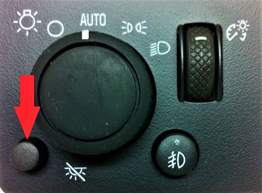

Start by pressing the dome light override button:
Are the dome lights off?
Ya, I pressed the button plenty, disconnected the battery cables and tried to reboot everything, didn't make the lights go off so it's garaged with a cable off.
